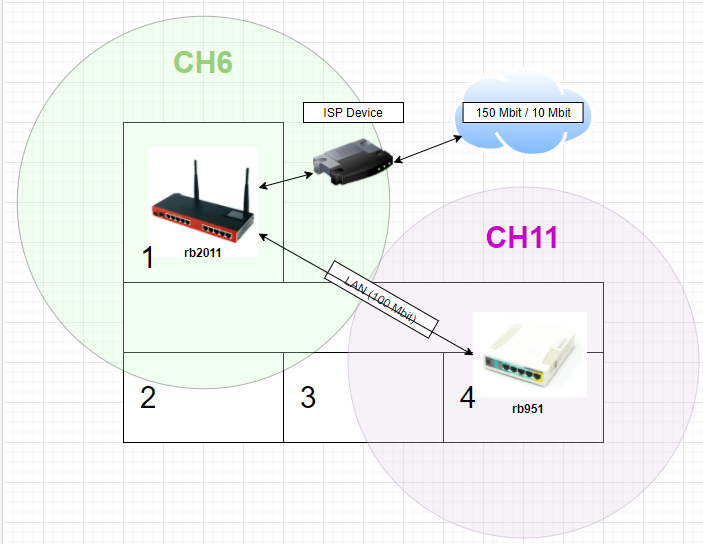

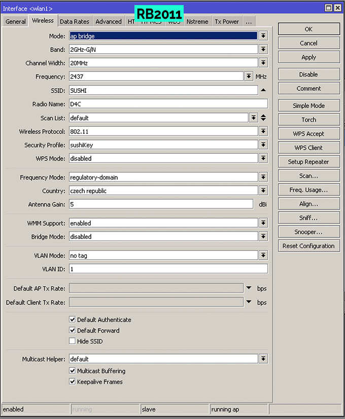

Topology can be seen on the attached image, both devices are connected & configured uring CAPsMAN. As seen from the wireless interface configuration, I am using G/N only 20MHz channel on 2412 (channel 1). I have tried to fiddle with antenna gain a little bit, but no results so far.

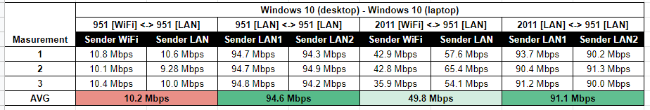

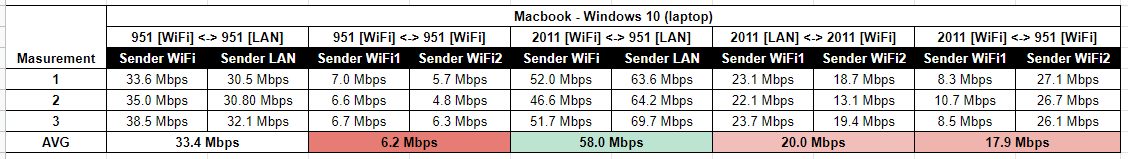

Thanks for the answers and corrections!

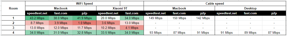

I have made local measurements with iperf. Results are confirming my hypothesis about bottleneck in WiFi between20 - 30 Mbit.
Two sets of measurement has been done - first is using my desktop with W10 and one laptop with unknown WiFi card (however it is one year old so I suppose modern standards).
The second is using the same laptop with W10 and Macbook from late 2019.
I will do a signal measurement and also switch one AP to channel 6 (room 1) while keeping the other one set to channel 1.

2.4 GHz is usually pretty bad except in remote places, way too much interference. You should also enable WMM if you want 802.11n to work.

  • I have enabled WMM, thanks.

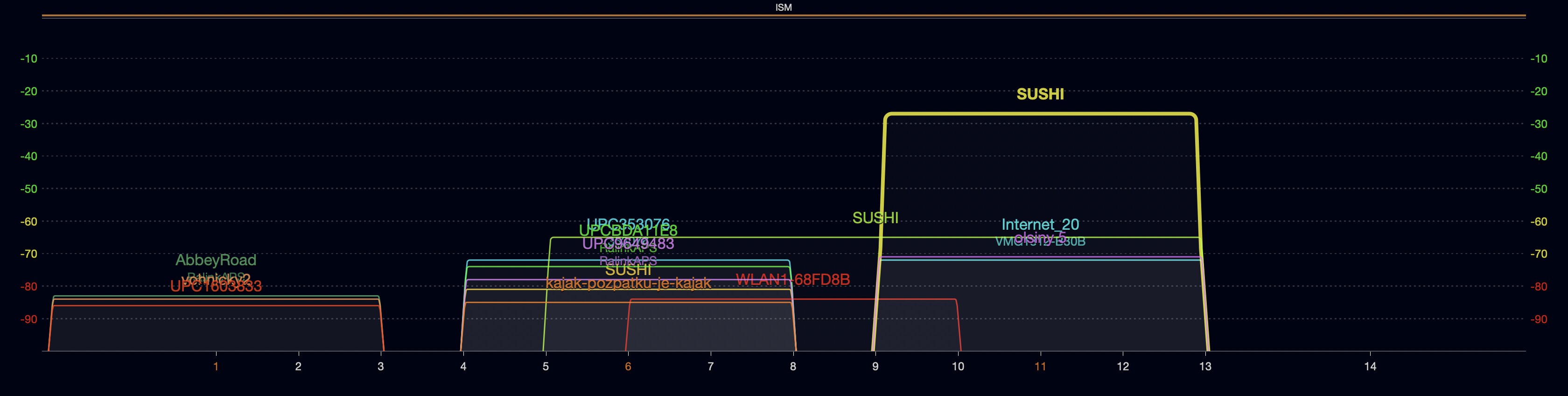

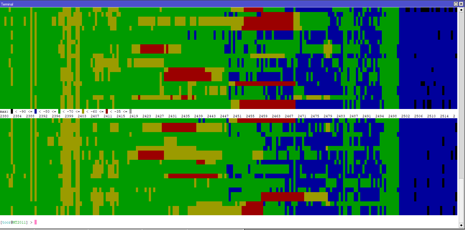

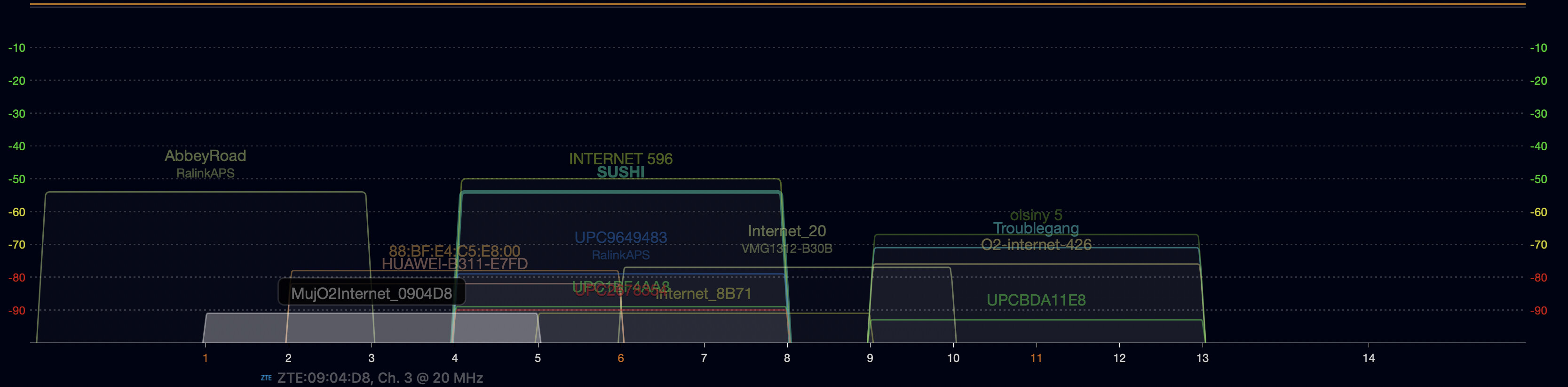

I have done channel analysis near the routers and I have to say: channels are pretty busy :smiley:
I am considering 5 GHz more and more.

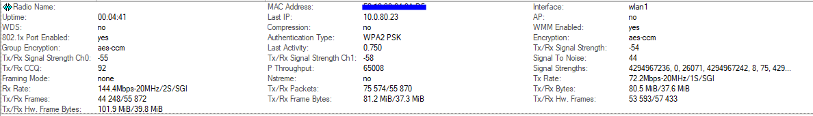

I see all sorts of “indirect” measurements, good enough to test if all is working fine, but not specific enough to identify the cause why it is working OK or not.
The information is in the Mikrotik, very easy to access and gives a very clear indication what is going on with every wifi connection.
The information is in the “Registration” tab of “wireless”, you must add more columns or use “detail mode”. (CLI “/interface wireless registration print stats”)
rx-rate=, tx-rate=“65Mbps-20MHz/1S/SGI” → interface rate -bandwidth/# of streams/short guard used
frames=, hw-frames= → ratio defines # of retransmits
signal-strength=, signal-to-noise=38dB signal-strength-ch0=-74dBm signal-strength-ch1=-70dBm → signal should be above -75 dBm, SNR larger than 25 dBm
tx-ccq=, p-throughput= → CCQ is quality of signal, % of transmission that is successfull.
This at least is about WIFI ONLY characteristics.
When this is in perfect condition then;
Expect on 2.4 GHz an interface rate of 144Mbps-20MHz/2S/SGI
Expect on 5 GHz an interface rate of 400Mbps-40MHz/2S/SGI
The free airtime is seen with “Freq Usage”. (100-Freq Usage) is the free time.
Payload data rate is 50% of (interface rate * CCQ * (100-frequsage)) if in one direction (half duplex) , 25% if in full duplex.
So the 400 Mbps of 5 GHz with 100% CCQ and full free airtime is the same as a 100Mbps ethernet cable in full duplex load.
Repeating the wifi signal will half the available airtime and throughput.
So repeated 2.4GHz (wifi-wifi) with perfect connection (144Mbps-20MHz/2S/SGI),(100%CCQ, 0 Freq usage) will allow up to 36 Mbps half duplex. (TCP is always partly full duplex for the ACK’s)

When I connect to the main 2011, stats can be found in Wireless/Registration and are the following:
> /interface wireless registration-table print stat
interface=wlan1 mac-address=F1... ap=no wds=no bridge=no rx-rate="130Mbps-20MHz/2S/SGI" tx-rate="72.2Mbps-20MHz/1S/SGI" packets=65676,40558 bytes=82658488,20721003 frames=36773,40560 frame-bytes=83349089,20477891
   hw-frames=44517,41318 hw-frame-bytes=104410186,22253242 tx-frames-timed-out=0 uptime=1m5s last-activity=10ms signal-strength=-53dBm@6Mbps signal-to-noise=45dB signal-strength-ch0=-55dBm signal-strength-ch1=-58dBm
   strength-at-rates=-60dBm@1Mbps 44s800ms,-53dBm@6Mbps 620ms,-54dBm@HT20-1 37s960ms,-53dBm@HT20-2 18s980ms,-54dBm@HT20-3 210ms,-54dBm@HT20-4 130ms,-53dBm@HT20-5 5s630ms,-53dBm@HT20-6 10ms,-53dBm@HT20-7 1s100ms tx-ccq=94%
   p-throughput=63990 last-ip=10.0.80.23 802.1x-port-enabled=yes authentication-type=wpa2-psk encryption=aes-ccm group-encryption=aes-ccm management-protection=no wmm-enabled=yes tx-rate-set="OFDM:6-54 BW:1x SGI:1x HT:0-15"

Not so much to see. I don’t know where the rest of the CAPsMAN information can be found.
frames/hw-frames don’t point to extreme interference on the RB2011.
However you own SUSHI channels do overlap. This will introduce co-channel wait times. The adaptive-noise-immunity, very good for weak background signal suppression, will not help for this co-channel wait.
One SUSHI is even very strong (>-30dBm) , testing very close or too strong AP ?
Clients only connect at 1S (single stream). This may be due to client hardware, but also limits expected PHY to 72Mbps, with a max data rate of arround 35 Mbps.
The PHY at 6.5Mbps is rather problematic, and this with a strong signal of -39dBm. This does not even take the interference into account, unless the interference is dropping packets and as such forces the PHY to select a lower rate (lower more robust MCS). This can be caused by interference, diffraction (by wall), reflection (by wall and metal surfaces), distortion (by wall and other objects and by using a too strong AP signal).
