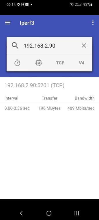

After some testing/experimenting … it can be done, sort of ?
HapAc2, running ros7.2rc4, connected to 1Gb switch.
Regulatory domain / Country etsi2 / any installation, Frequency auto = channel 149 selected (SRD channel)
Channel width set to 20/40/80 XXXX (since I’m alone there as far as Wifi scanner on PC tells me :laughing: )
Power manually adjusted to all rates fixed / 10 (AP is 40cm away from me, might still be too much)
Iperf3 server on linux box, connected to the same switch as HapAC2.
From laptop wired on the same switch I get 950-ish Mb throughput, proving the switch is more then capable enough.
I also tested connecting the laptop to HapAC2 eth port, same result. Switch and HapAC2 are able to handle the traffic just fine.
Using Samsung S20 connected to 5Ghz, HE.NET tool on device, 10 seconds and 200Mb package, I get speeds consistently above 390Mbps (I’ve seen 511 on 1 occasion, mostly around 400).
I do not get those speeds using TPLink Deco P7 (no config possible at all, purely auto !), nor Sitecom WLX-7000 (VERY limited config possible, only first 4 channels of 5GHz band available which are overcrowded already where I am, no option to use ac only).
Using the normal lower 5GHz channels on Hap AC2, I can get to 227/230 max. Not more. More or less the same as on those other APs.
But then again, my outgoing connection is 200/20 (reality 193/19.7, tested every hour), so why should I care about “only” getting 200-something over Wifi at home ??
Anyhow, the major take-away point, I think (which bpwl always says): the channels you want to use need to be as clear as possible from whatever interference.

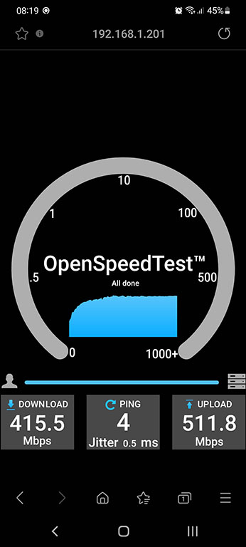

IM getting this on practically any mikrotik AC device, HAP,CAP,WAP, and with multiple clients like phones or laptops etc..
This example from capsman in local forward and WAP AC, S21 Ultra, 3m away, mostly clear environment, less than 10 clients doing no traffic same time as me during test.
Here is one of the results I took a screenshot from, a fair bit above 400Mb.
