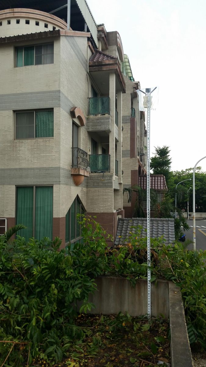

What would be the cons if I put indoor antennas on NetMetal 5? I’ve to admit that I didn’t realize how expensive an outdoor antenna was before I purchased the NetMetal 5, so I used 3 indoor antennas from my previous ap - Netgear WNDAP330. This unit is for residential purpose only. My house is a 5F building and I wish I could have good wifi reception on every floor. Therefore, I have this idea of setting up an outdoor AP on top of my garage about 6M away from the building. Here are the photos.
Since the indoor antennas are not weather sealed, I cover them with plastic bag. I hope they will last longer.
Sure you can, but the device itself might be a little “overkill” for such close range setup. In any case, it should work just fine and you don’t even need the bag over it, since the connectors are sealed.
