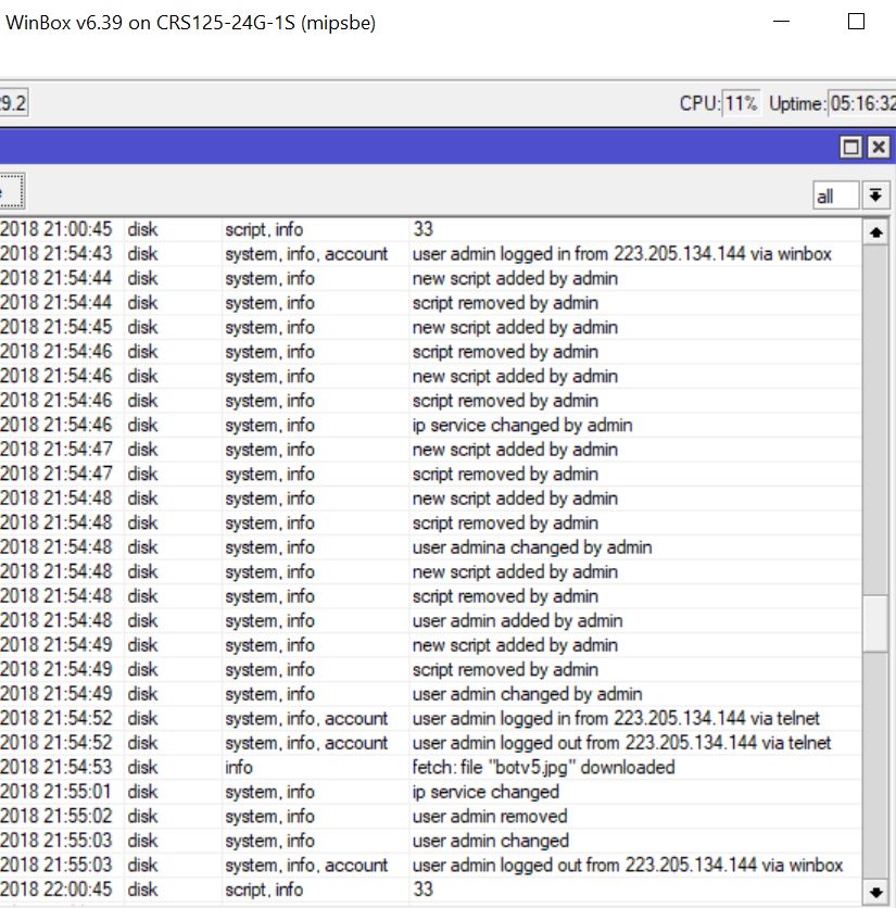

Log shows that after winbox access, telnet was enabled and a number of scripts added, ran, and removed. A file ‘botv5.jpg’ was fetched.

We had this happen yesterday as well we are running 6.39.2 but unsure now how to clean things up. I have disabled services ftp and ssh for the moment. How do we tell what scripts were run while compromised?

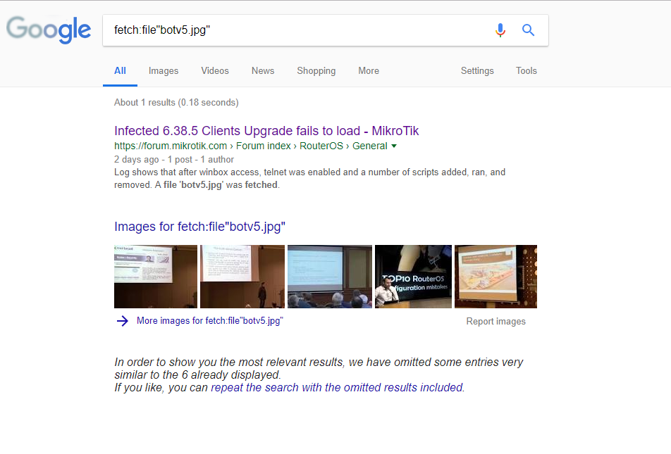

This thread was the only one that came up in google search , the images link back here as well.
I guess your search was too precise. Had you tried “MikroTik infected” , you would have gotten much more.
