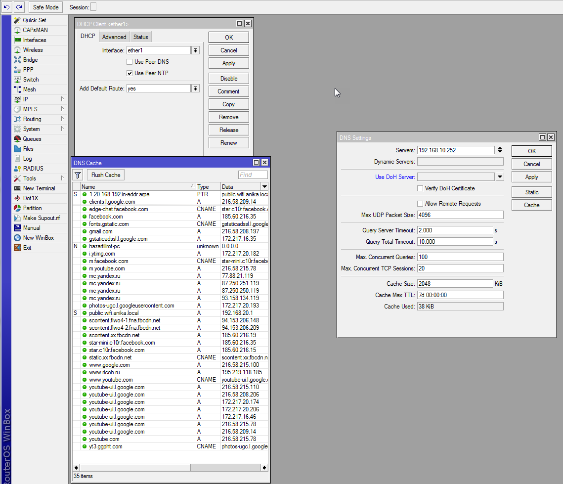

Thanks to tdw. I did as you said. In the previous screenshot I went to the DHCP client and got rid of the use peer DNS feature. Then I switched off the inner DNS server last night knowing exactly that nobody gets the Internet.

Here is the interesting thing. When I connect to a hotspot, the router requests my inner DNS server to resolve domain names it then gets response back, caching it and responses to a client request. Meaning that it’s in charge of those requests anyway. However it doesn’t make requests for my local domain names for no reason. If you look at the snapshot I took yesterday there is hazartilirot-pc that got unknown type and a blank IP address like 0.0.0.0. It’s all the same with a provider DNS or my internal one.
Might it be a kind of a MikroTik bug? Should I report the issue?
The DNS lookups via the Mikrotik and your bind server appear to be working as expected. The N hazartilirot-pc unknown 0.0.0.0 cached record shows that the upstream DNS server (your BIND server) replied with NXDOMAIN so the type and data fields have no value, hence the suggestion to check the BIND server activity/logs.
