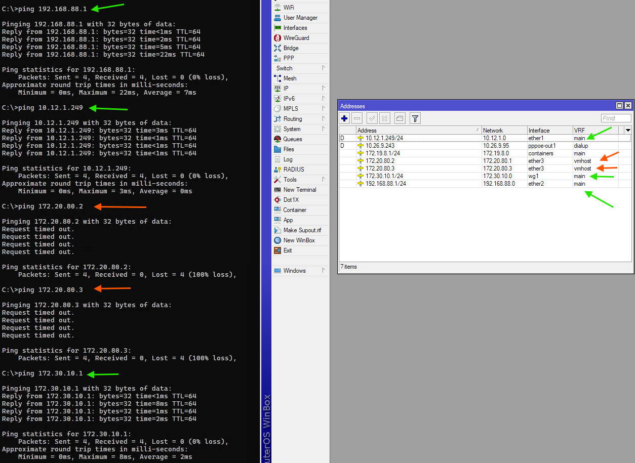

Although it's possible to have the isolation you want without firewall rules, by placing the subnets in different VRF:
But using VRF just for the sake of disallowing ping to local addresses is very wrong!
