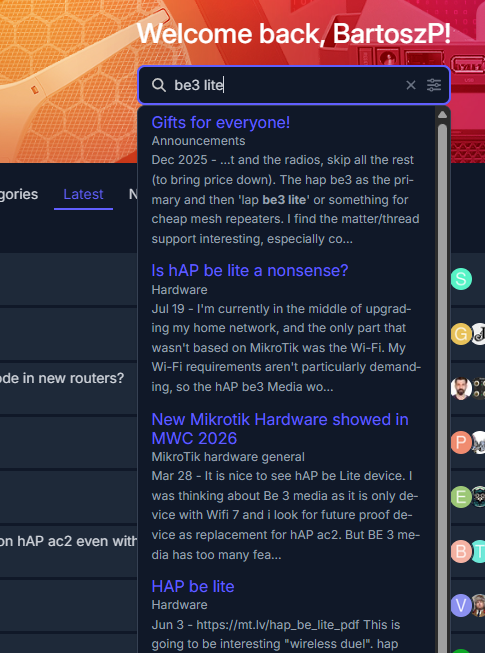

there are a lot of topics covering your questions.
Search the forum for hap ax or be and you can check what the opinios are like?
hap be is quite young device so there is not to much experience with it.
Thanks, I tried to do my research beforehand and only found a comparison between the ax² and the be lite from a few months ago. The latest answers regarding the be lite also seem to be from last month, so I'm wondering if there are any newer insights by now.
