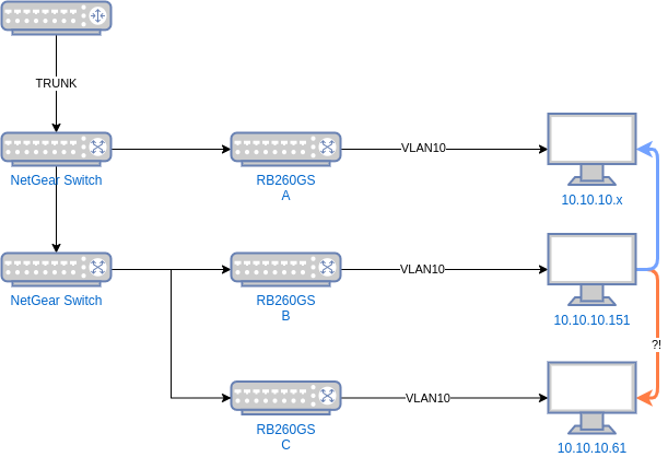

I am having a weird issue with my VLAN. with the following topology:
I have one device connected to C which is mostly unrechable, and I don’t know why.
The switches A, B, and C are connected to trunk which serves VLAN 10. I can reliably connect to all devices behind switch A, but I cannot reliably reach 10.10.10.61 behind switch C.

The switches are all configured the same way: eth2 is the trunk port and eth3/eth4 are access ports for VLAN 10. I did this under VLAN
  • eth2 as trunk, eth3/4 as access port for VLAN 10
  • VLAN → eth2: VLAN enabled, only tagged, egress add if missing
  • VLAN → eth3/4: VLAN enabled, only untagged, VLAN ID 10, egress always strip
  • VLANs: VLAN10 with all Not a Member except for eth2 (add) and eth3/4 (strip)
When I connect device 61 to switch B, I can reliably reach it.
When I connect my laptop to the ethernet cable which device 61 is connected to, I cannot reliably reach all other devices.
When I connect my laptop to switch C (actually to a Netgear switch in-between which device 61 is connected to), I cannot reliably reach device 61,
but when I replace switch B with switch C and still have the laptop connected to the Netgear switch, I can reliably reach other devices. So it must be an issue with switch C.

Is there something wrong with my configuration?
Also, how can I debug this type of problems? I cannot see anything in Wireshark except that I don’t get a ping reply except for some rare cases.
Thanks,
Simon
PS: After upgrading the software from 2.7 to 2.13 and loading the configuration from the working switch, everything works fine.
