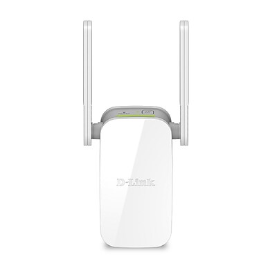

I tried to replace Router 2 with a common D-Link access point and it works
Both routers use same IP address range, this can not work.
Change the IP address range on 2nd router to xxx.xxx.89.x for instance (and DHCP server etc).
TP Link works because it probably uses the classic 192.168.0.x/24 net
