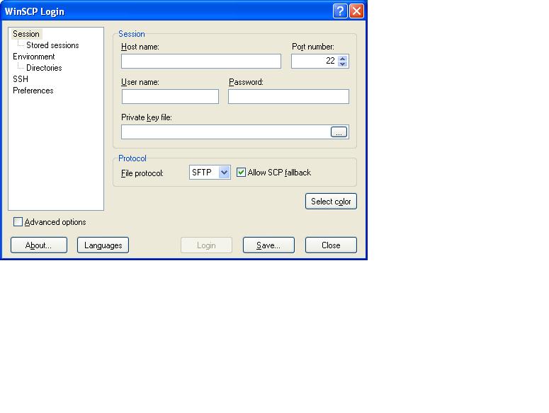

To install or upload user-manager in the router, you can use this software to upload the file without any problem, http://winscp.net/eng/index.php. Download and install, then login to the router with the ip address of the router, the username and password, then the rest is history.
See the diagram below
Here you just upload the file to the root folder, that makes it to be installed accordingly.
