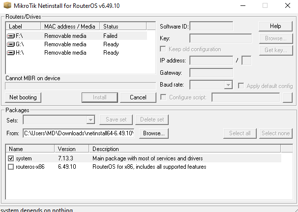

try to install RouteOS (tried 7 and 6) on CF Card with Card-Reader (later for an alix apud)
pre:
yes, i have changed the CF-Cards and reader twice (with new ones)
Please see secreenshot.
Can you help ?

“Cannot MBR on device”.
This may mean that the issue is related to the way the CF card is seen by the OS
If you are using Windows, in many cases the CF card (through its reader) is seen as “removable” device, as such Windows will not let partition it (please read as “won’t create a MBR”), the device is substantially seen as a super-floppy with the PBR/VBR as first sector.

Cannot say if this is the issue you are experiencing, but you can also make a MBR and a partition manually (using a virtual disk driver on an image and then deploying it to the CD card (avoiding the use of the filter driver) Windows is working fine with an already partitioned “removable” drive, but cannot say if Netinstall wants access as “fixed”.
tried diskmod.sys, but card reader was not seen anymore in diskmgmt etc. so, for now i think i am not able to use this way or is linux-cli able to write on CF ? checked but not seen anythink in syntax.

It is strange that diskmod didn’t work, it is a tested tool, maybe it is your (newish?) windows version or the CF card adapter driver that is not compatible with it.
You can still use a live linux distro, like gparted, should do nicely.
Once a disk has a MBR and it is partitioned, windows can use it normally (what netinstall expects may still be different).
