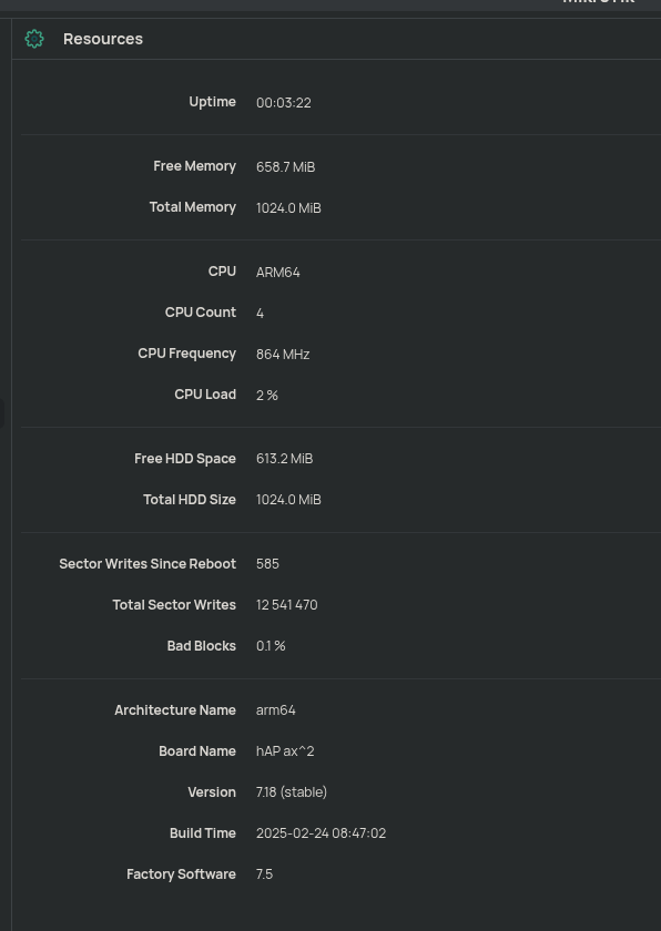

In the resource page i have these values:
Free HDD Space: 976.4 MiB
Total HDD Size: 1024.0 MiB
Bad Blocks: 0.1%

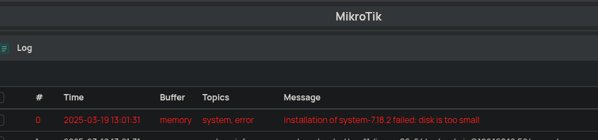

Log:
2025-03-18 22:46:03
memory
system
error
installation of system-7.18.2 failed: disk is too small

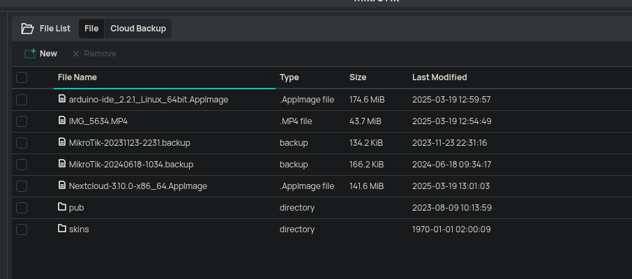

I uploaded a video file that has 65MB, no issue. I think i performed between 20-30 updates after the flash chip replacement, i don’t believe the issue is the flash, but how the free space is calculated.

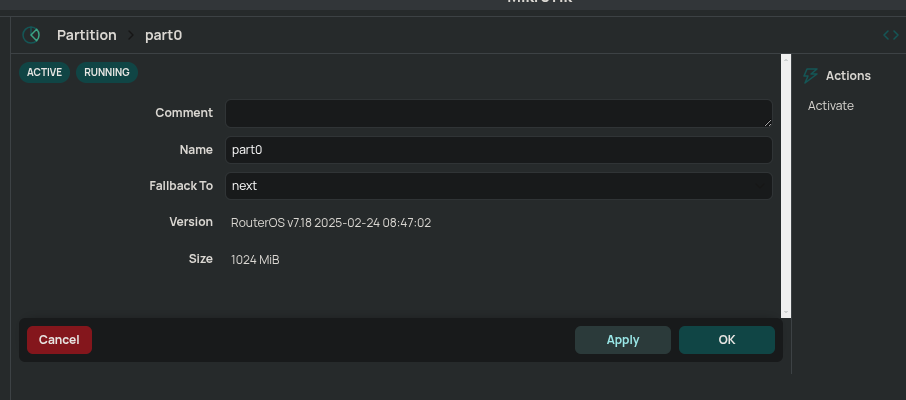

I totally agree, i decided to cancel my warranty when i performed the flash upgrade, but if in the code was introduced a new condition that instead to check the real free space (like resource page is doing) vs the required space for update installation, then there is a bug, even if it don’t affect the production models. If i perform netinstall and it is working i think if the bug remain there i will not be able to perform any GUI update.
there was some issue around that version where the kernel partition was too small (i don’t know - sometimes?), and some sort of repartitioning took place automatically. There may be some hardcoded values there. Anyhow, I’m willing to bet you a flash chip (ha-ha) that after a netinstall it will work.

Thanks for the advices. I did a netinstall to 7.18.2. Now i will wait for the next release to test this.
Probably free space more than 134217727 bit cause variable overflow.
On your spare time, can you try again the passage from 7.18 to 7.18.[1|2] leaving on purpose free space less of 134217727???
