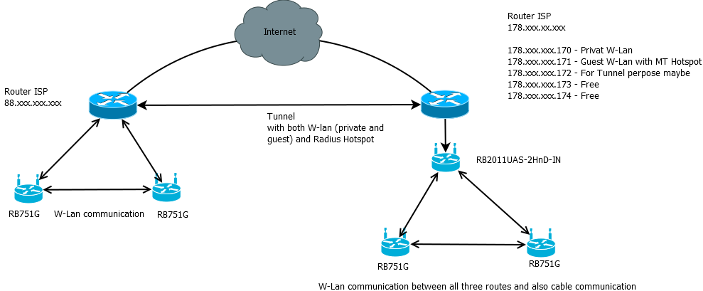

Hopefully somebody can help me. I’m running a bed & breakfast with 2 house. One with only apartments and in the other only rooms and a cafe/restaurant. I want to serve my guest a free w-LAN and found Mikrotik. Somebody who was to help me, left me alone with no working internet. There is so much to install and I can’t do it on my own. Can somebody please help me. I left a image of what my idea is.
The thing is that no matter where my guest are, (cafe/restaurant, room or apartments) they will get internet on the guest w-LAN with the same code/voucher I give them.

I think you have to post some more info about your setup.
Im not sure, but do you have 2 routers to internet? Yo want one radius server (for hotspot?) and use same user/pass at both sites?
Then I would use on box to “terminate” all and be a gateway to internet. Have site 1 and site 2 routed into this hotspot gateway, and nat,route or do what you want from here, by authenticate users. Use this one internet connection for all customer.
Its possible to have a radius client at both sites, connecting to a shared radius server. Then you need a radius server ( let say mikrotik box) configured to the two hotspot gateways.
There are more than one solution here, and you need to provide more accurate info about your net to make a good conclusion here.
