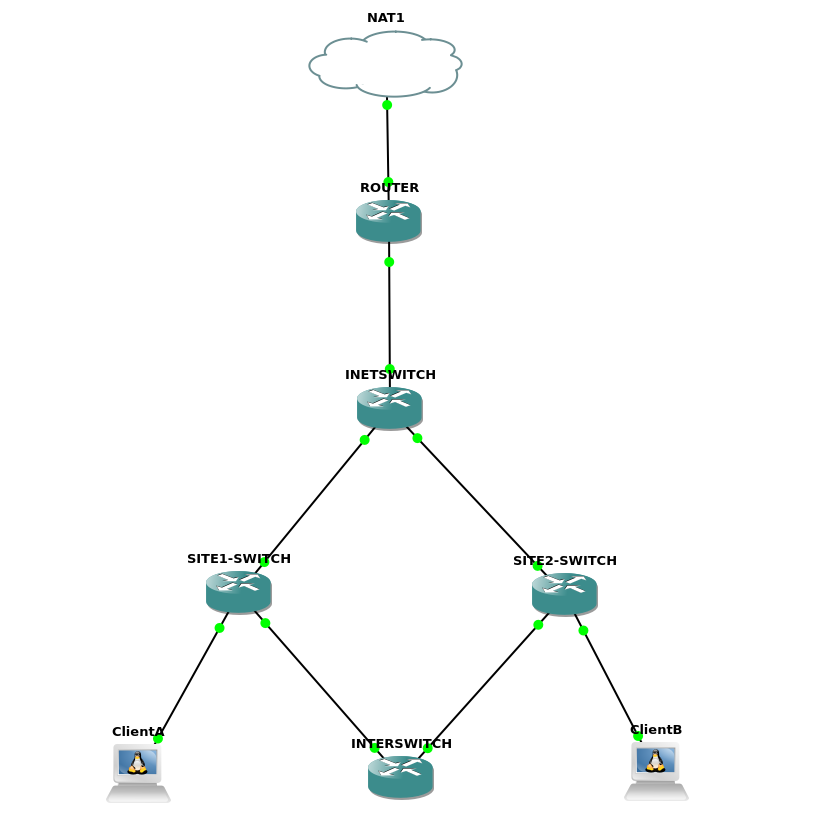

Hi I have a problem regarding VLAN connection across switch. I’m using gns3 to simulate the problem.
The main purpose is to let Client A connect to Client B through high speed connection (FO) when using specific IP
This is the topology
Note :
  • VLAN 100 are for internet
  • VLAN 300 are network device management port
  • VLAN 131 are high speed switch (FO)
  • All network device use Mikrotik CHR-6.48.5
The Client A and Client B using static ip for both VLAN 100 and VLAN 131 under single port
Client A cannot ping to INTERSWITCH (192.168.130.1)
Client B can ping to INTERSWITCH (192.168.130.1)
If I remove the connection either SITE1-SWITCH to INETSWITCH or SITE2-SWITCH to INETSWITCH
then both Client A and Client B can communicate to each other using VLAN 131, but at the cost of Client A cannot connect to the internet ( VLAN 100 )
It seems like there is a loop somewhere. But I’m unable to find the problem.
This is the configuration

One of the paths forming the inetswitch - site1switch - interswitch - site2switch loop will be disabled by spanning tree, and as you do not have the same VLANs configured on each path connectivity will be lost.
If you wish to have redundant paths with blocks on different links for some VLANs you will have to configure MSTP. Otherwise if you have no layer2 loops for each VLAN you can disable spanning tree either by setting protocol-mode=none on each bridge, although this results in the bridges no longer being 802.1D compliant, or setting edge=yes on each bridge port.
Hi, thanks for the info I still getting my head around MSTP.
Currently in this case I don’t need redundant connection between SITE1 and SITE2
the purpose is for VLAN131 packet go to interswitch, it will be use to communicate internally between site
also it will be used by specific software in the client, and it doesn’t need to touch inetswitch and other vlan
So I added mstp info, but not sure why this is working.
All bridge frame-type is admit-all maybe this is the culprit
