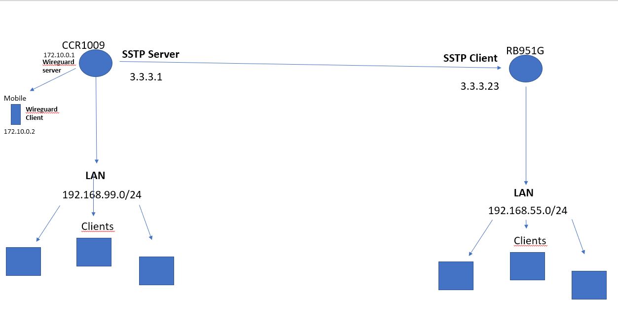

Hello everyone, i need to connect two VPN networks, one is a SSTP and other is a Wireguard. i have a CCR1009 as SSTP server and Wireguard Server. And also have a RB951G as SSTP Client and serving as LAN Router
i’m connectig computers and mobiles phones and they don’t see it each others
i need to connect all the devices to all others
thanks and regards!

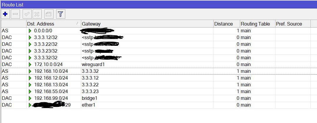

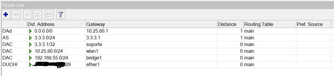

Why complicate your life with two disparate VPN networks.
I would use ONE wireguard network to join the two routers and which would allow me to access both routers as a road warrior for subnet access or both routers config for admin access etc…
The reason to use SSTP between two MT devices is that its fairly straightforward and easy by use of IPSEC secret.
I would use SSTP as backup between the two device in case wireguard for some reason was not working.
Just to be clear do both MT devices get public IPs ( if both do, then I would also have a backup wireguard for the second device in case the main router was down for any reason).
If your connection are establish and work its all about firewall rules, routes etc…
