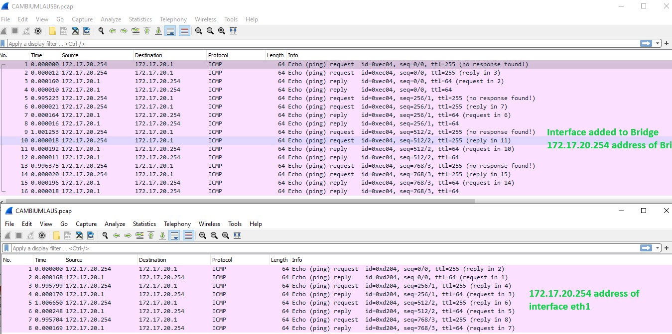

using multiple Mikrotik HeXS in our network we noticed packet loss. Almost every third packet is lost. Packet loss occurs even on the link where the router and the device are directly connected.
When we turn off the bridge and set the ip address directly on the interface, packet loss stops.
The figure represents mikrotik HeXS (172.17.20.254) and another device (172.17.20.1) directly connected by a LAN cable.
What could be the problem?
Post the config of a sample hex…
