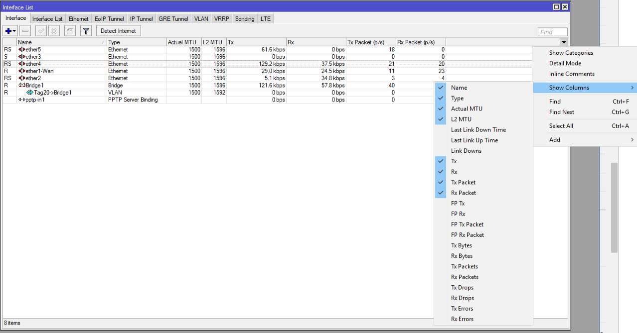

But from Winbox I do see this:
Why do cli show speed=100Mbps?
Is this a bug?
I do also like if MT add columns to show IF actual speed in the main Interface view.
Not a bug, just a recent change of default setting.
This is the speed to use when auto-negotiation is off, so this setting is not active in most scenarios.
Previously the default setting was 100Mbps, and it was never shown in export unless you have manually changed it to 1Gbps.
The default setting for gigabit ethernet ports has changed to 1Gbps in one of the recent ROS updates, but as you still have 100Mbps in your config, your setting is now different from default - and thus shown in the export.
If it bothers you, just set it 1Gbps for all gigabit ethernet ports and it will disappear from export.
