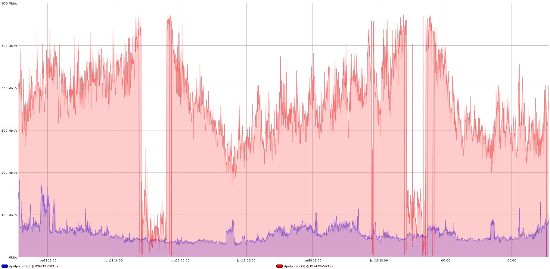

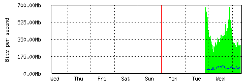

I haven’t tested this in a lab to verify yet, but it seems like our Dude interface graphs start cutting out at around 575 Mbps. At first I thought this was an issue with the Cisco 3750 we were using for the graphing. But I changed to graph the interface on a CRS317 and get the same results. Graphing on the CRS show peaks around 700M, but the Dude shows ‘holes’ on anything over about 575M. I don’t see any settings for the link graphing other than SNMP and setting interface type to gigabit ethernet.

I think you are right on the snmp counter, but I don’t see how to change the default for graphing bit rate on a link. I just have the ‘Graph bit rate’ box checked for the link and using SNMP for mastering type. The SNMP profile for the device is SNMP v2. Also, the monitoring interval is 1 min and setting it to less than 60 sec doesn’t make a difference. It seems to use a 1 min avg no matter what I set the polling interval to, although I didn’t try going more than 60 sec.

Go in Settings > Map > Label Refresh Interval
The shorter the time set, the greater the limit that the Dude avoids cutting the chart
I’m currently using 00:00:10 to graph 2gbps on interfaces
That worked. Thank you very much!!
