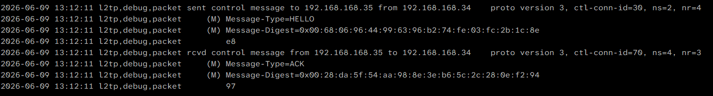

I've got a hub-and-spoke arrangement between 4 development L009's with RouterOS 7.23.1, one as an L2TPv3 server and three as L2TP-ether clients. The interfaces work fine and can pass traffic.
Unlike "regular" L2TP connections however, the server does not list the interface in the l2tp-server menu and I can't find a way to refer to them in a static manner, and hence you can't add them directly to a bridge or to an interface list; in fact there's very little that indicates a client is connected at all:
Screenshot 2026-06-12 095019
The only way I've found is by tabbing at interface= prompts or by turning on L2TP logs specifically:
You can add the dynamic entries to a list, but as they can change there's very little point in it and you just end up with a load of red dereferenced pointers.
The only way I've found to reference the connections so far with any kind of reliability is using the built-in "dynamic" interface list, which in this use case is fine, but seems like I'm either missing something obvious or the feature is incomplete.
