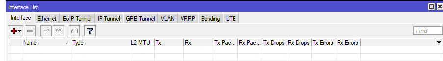

interface list "disappear" in RB411
Hello
another strange problem
I’m using V5.24 (and also try it on V5.18)
all I have is ppp-client that connect to the internet and nat
add action=masquerade chain=srcnat disabled=no
and that is all.
also I’m using this modem Huawei EM820W
after 3-4 hours is stop working and I can’t see any one of the interfaces
but other things I can see - like clock,scripts,dns…
what could be the problem?

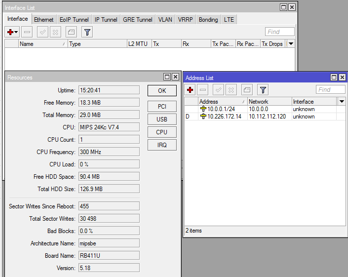

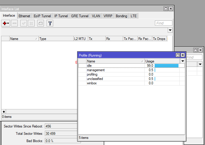

How does the CPU look when that happens? If high, check also Tools/Profile and see what is using CPU.
nothing on the CPU
as shown
