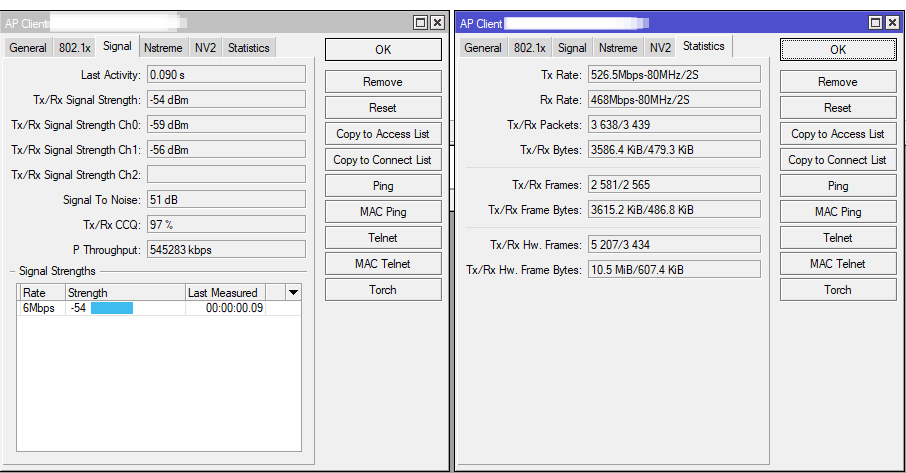

Secondly, you should identify what rates do your device achieve by going to wireless → registration table and doubleclicking one of devices:
I believe it will be easier to figure out solution with this additional info.
