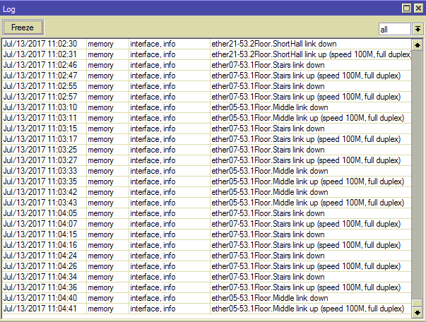

Hi All,
Has anyone seen interfaces go up/down every 3-5 seconds?
This is a CRS125 with Mikrotik RBcAP2n Access Points attached:
Just started happening after upgrade to 6.39.2 however occurs on firmware 6.38.7 (bugfix) too.
