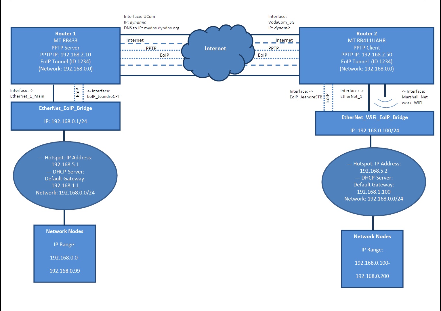

I’ve recently setup a vpn between my to homes via the internet. The vpn uses a PPTP tunnel to connect both networks via the internet. Within that tunnel I use an EoIP tunnel to transparently bridge the two networks.
I used the following guides to establish this connection:
http://wiki.mikrotik.com/wiki/Manual:Interface/EoIP
http://www.mikrotik.com/documentation/manual_2.7/Interface/EoIP.html
Please refer to the network layout diagram bellow.
The PPTP connection seems to work correctly and the EoIP Tunnel as well. The only problem I have is that both networks run hotspots. This seems to interfere with my internet browsing and general internet connection of the nodes at both locations. It seems that if it try to access the internet on one of the nodes in network 1 (router 1) then it redirects me to the hotspot login page of network 2 (router 2).
The idea was to setup both networks on the same ip range but limit the addresses on both networks to specific ip’s within this range, so to avoid duplicate ip’s.
I first had a major issue with the dhcp-servers on both network. I didn’t want to run one dhcp-server to serve both networks (in case the internet connection went down). I then found out that a bridge filter run could be applied to block off any dhcp requests from the one network to the other by dropping any requests through the eoip tunnel that use ports 67-68 of the udp protocol. That seemed to solve the problem of the dchp-server interference.
The two hotspot html login pages are on a different ip range then the local range of both networks. I then tried to block any requests through the EoIP tunnel to that (hotspot login page) ip range. After a while the it seemed I could access the internet via the network nodes while the pptp connection, eoip and bridge were enabled. I don’t know if it was a result of this hotspot page ip blocking, because when I disabled this rule in the bridge filter, the internet still worked.
Furthermore, despite trying to transparently bridge these two networks, I cant seem to ping the nodes of network 2 from the nodes of network 1 and visa verse. I’ve tried multiple combinations of proxy-arp on the network interfaces of both bridges, but no success. I added walled-garden ip rules on both hotspot to allow any local traffic. This enabled me to ping router 2 from router 1 but I could still not ping nodes within network 2 from router 1. When trying to ping address 192.168.0.140 I get a response in winbox from 192.168.0.100 (local ip of router 2): host redirect.
I also can’t seem to use winbox to connect to router 2 from network 1 (it is stuck at: retrieving preferences from 192.168.0.100). I can only use telnet. And it is unstable at best. It often disconnects. I have a feeling that my mtu and mru setting for all the interfaces are wrong. As I understand it the mtu of the outer tunnel (pptp) is to be the largest followed by the inner tunnel (eoip) smaller and the bridge the smallest. Is that correct? and if so, what are good values to use?
All that I would like this vpn to accomplish is the ability to see the network nodes on network 2 from the nodes on network 1, via windows’ network discovery (ie not using the nodes’ ip addresses in windows, but for windows to discover them automatically). But each network should still be served by its own dhcp-server and should still be governed by its own hotspot. Thus if the pptp link between them fail, they would still be able to operate as individual networks.
I would greatly appreciate any help with this. Even if it is just pointing me in the right direction.
The network layout is as follows:

Just for clarity, I have a script updating my dns domain name frequently on Router 1 and script that checks and resolves this dns domain name against the current ‘connect-to’ ip address of the pptp-client on Router 2. Thus ignore the mydns.dyndns.org connect-to parameter of router 2.
I would realy appreciate it if someone could perhaps help me out with this. I don’t believe my mtu/mru setting and arp settings are correct. Could anyone please advise me on this.
Thanks so much.
Kind regards
That’s an outstanding network diagram and problem description. Awesome. I wish everyone posted like that. Some of that doesn’t make sense to me, though. Your default gateways on the LANs don’t match the network IP space (in the diagram only, the CLI output sees to have it right), and neither does the Hotspot IP. The Hotspot should be running on the default gateway IP.
Your main problem is that the Hotspots are doing exactly what they are supposed to be doing - they’re redirecting all traffic on the broadcast domain to themselves. Your broadcast domain spans both locations. Running two Hotspots on the same broadcast domain is definitely not recommended.
Is there any chance of just turning off the Hotspots? That would of course immediately solve the problem.
Otherwise try setting the address-pool of the two Hotspots to ‘none’ instead of an existing pool. That should stop the Hotspots from ARP poisoning the network. That’s a guess - I’ve never seen anyone put up two Hotspots on the same network.
Thanks for pointing that out. I guess I was in a bit of a hurry when drawing up that diagram. Luckily the CLI is correct.
The reason the Hotspot ip is not that of the default gateway, is that it makes the usermanager login page inaccessible. I could give the hotspot login page an ip on the same network range as my network nodes, but I was trying that bridge filter in my earlier post and decided to place the hotspot’s on another range.
Do you perhaps know how I could configure the usermanager so that the login page is on ip of my choice?
