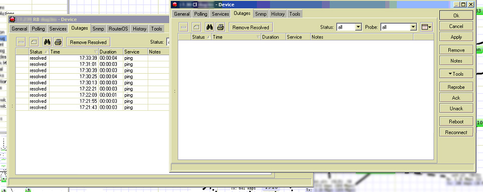

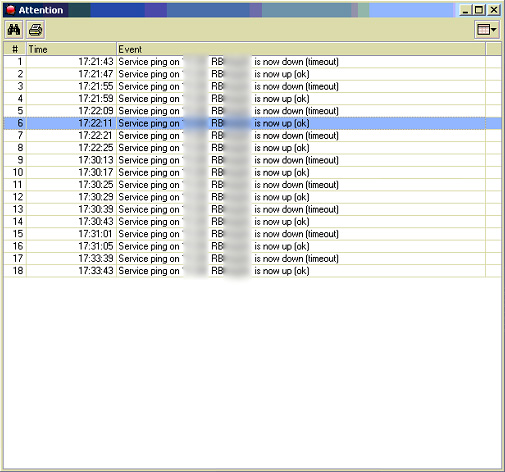

one of my RB450G interface have intermittently packet loss, like 3-5 seconds loss and about 3-5 times for every few hours. i said one of the interface, because i tested the other port(not every one them yet), don’t have this problem.
