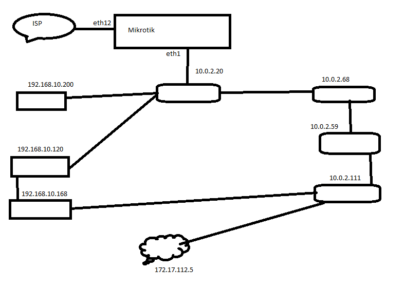

I have 3 vlans are from 1 mikrotik to local all POP switches and clients i.e

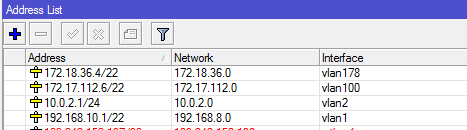

Vlan 1 is for my switches management IP Pool 192.168.10.1/24( static Pool)
Vlan 2 is for my switches management IP Pool 10.0.2.1/24(static Pool)
Vlan 100 if for my clients in branch office. 172.17.112.1/22( DHCP Pool)

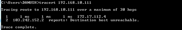

I have ping, telnet my both vlan switches ip’s from the Vlan100, Coming vlan1 it was not working and when i did tracert it was going to my upstream provider, Vlan2 all switches are able ping and telnet from the vlan100 clients end.
I have not done any nating or routing for any vlan’s.
Please help me on this.
Below attached sample network diagram.
Somewhere you have to do routing between different subnets (VLANs … that’s 10.0.2.0/24, 192.168.10.0/24 and 172.17.112.0/22 … the most sensible point would be your main router. To make sure only allowed/required connections between the 3 subnets, you should create appropriate firewall rules.
I need to know which firewall rules have to be add?

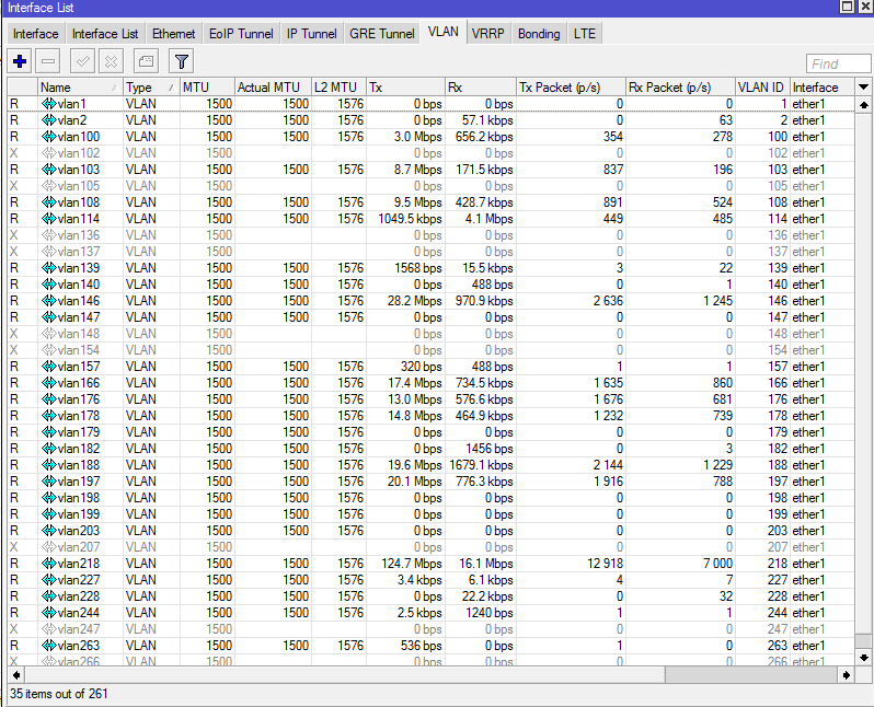

Not to guess too much … post your current config of your main router (execute /export hide-sensitive and post output in environment … redact public IP address if there is any).

[admin@E4:8D:8C:2B:96:B7] > export hide-sensitive

/interface vlan
add interface=ether1 name=vlan1 vlan-id=1
add interface=ether1 name=vlan2 vlan-id=2
add comment=ipv6 interface=ether1 name=vlan100 vlan-id=100
add interface=ether1 name=vlan102 vlan-id=102
add comment="Space Vision" interface=ether1 name=vlan103 vlan-id=103
add interface=ether1 name=vlan105 vlan-id=105
add comment="Sumantha Networks" interface=ether1 name=vlan108 vlan-id=108
add interface=ether1 name=vlan114 vlan-id=114
add comment=Hotspot disabled=yes interface=ether1 name=vlan136 vlan-id=136
add interface=ether1 name=vlan137 vlan-id=137
add comment=VIP-Pool interface=ether1 name=vlan139 vlan-id=139
add interface=ether1 name=vlan140 vlan-id=140
add comment=MYP-DP interface=ether1 name=vlan146 vlan-id=146
add interface=ether1 name=vlan147 vlan-id=147
add interface=ether1 name=vlan148 vlan-id=148
add interface=ether1 name=vlan154 vlan-id=154
add interface=ether1 name=vlan157 vlan-id=157
add interface=ether1 name=vlan166 vlan-id=166
add interface=ether1 name=vlan176 vlan-id=176
add comment=ipv6 interface=ether1 name=vlan178 vlan-id=178
add interface=ether1 name=vlan182 vlan-id=182
add comment=MDP-DP-2 interface=ether1 name=vlan188 vlan-id=188
add comment="010188-Saketh Comm" interface=ether1 name=vlan197 vlan-id=197
add interface=ether1 name=vlan198 vlan-id=198
add comment=022742 interface=ether1 name=vlan203 vlan-id=203
add interface=ether1 name=vlan207 vlan-id=207
add comment=MDP-DP interface=ether1 name=vlan218 vlan-id=218
add comment=010601-Jithu interface=ether1 name=vlan227 vlan-id=227
add comment=010310-Jithu interface=ether1 name=vlan228 vlan-id=228
add interface=ether1 name=vlan244 vlan-id=244
add comment=020920 interface=ether1 name=vlan247 vlan-id=247
add interface=ether1 name=vlan263 vlan-id=263
add comment="021102_J.S.S Communication" disabled=yes interface=ether1 name=
vlan266 vlan-id=266

If I got the config right, then your router is missing IP address on interface vlan1. Which explains why packets targetting that subbet end up sent towards ISP - router doesn’t have any direct route towards this subnet so it uses default route.

Thanks for your replay, I have removed vlan 1 that time so it was not there in the config file.

Still i have facing the issue with vlan 1 IP’s ping.

Did you configure IP address on vkan1 interface? An address from 192.168.10.0/24 subnet? Those switches, do they have default gateway configured? Is it the same main router?
I have added vlan in interface and added IP address of it.

For the vlan1 switch IP traceroot is going to Public network i don’t know why it was going to public.
