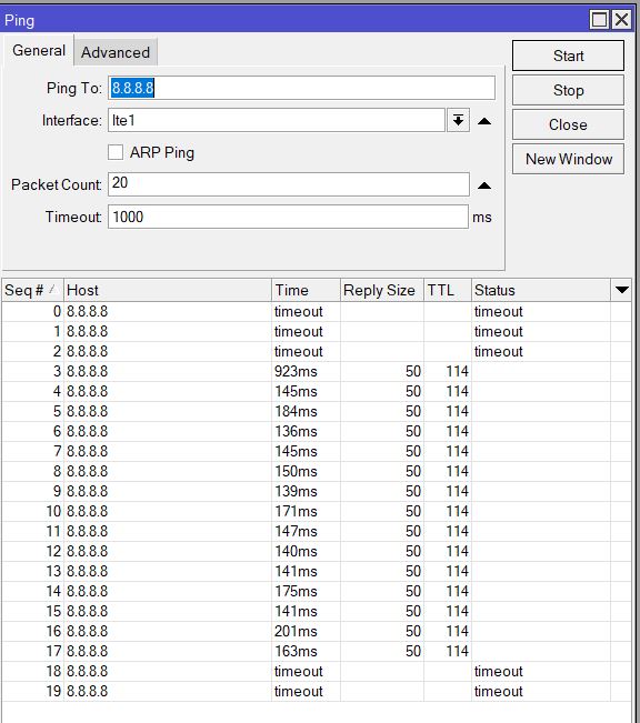

i attached the image of the ping done with winbox.
I used an apn from the provider . Wind . APN= internet.it
What happens, if you change timeout to some much larger number? I guess none of pings would get dropped but they would show pretty long RTTs. And I guess with long RTTs quite some services will fail.
BTW, even the “short” ping times (around 140ms) are quite long for 4G (LTE) connection, median ping times should rather be 30ms to 50ms. It’s hard to tell why these times are so long though.
Ping test is good to know “if” something is wrong, but gives no hint to “what” is wrong.

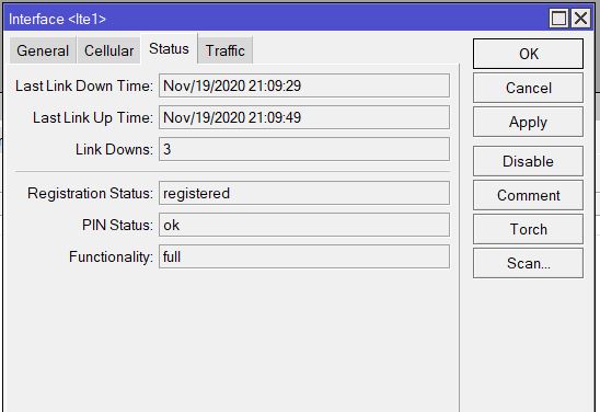

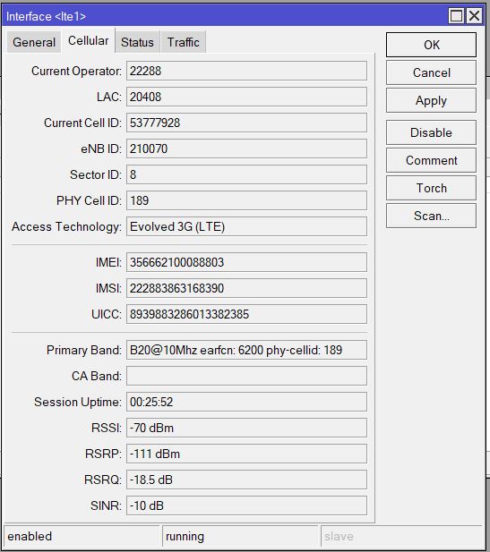

So what is the Cellular information of the LTE interface. And what is in the log as connection information?

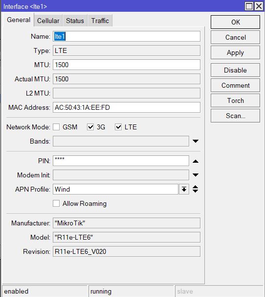

Your timeouts look more as for a 3G connection. (Did you disable 3G?)

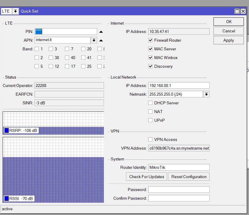

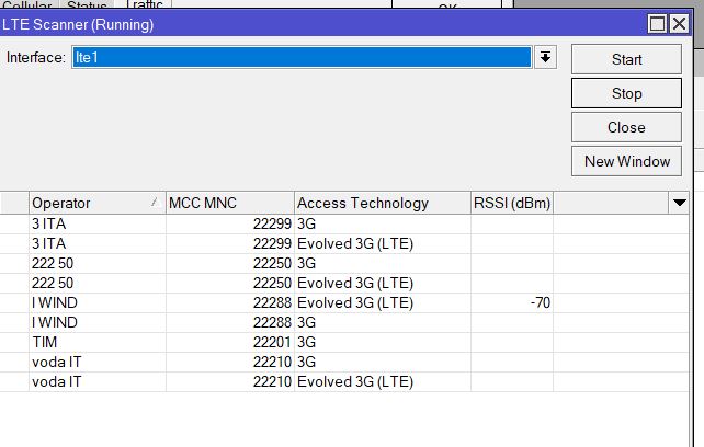

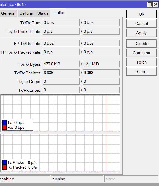

I have attached some pictures from winbox as requested.

Signal strength (RSRP) is quite poor at around -110dBm, it can be considered cell edge. If it fades by only a few dB the connection between cell tower and your modrm can break (or block).
As it was working for you until a few days ago and if cell really works without any problem, then the only possibility is that your antenna got missaligned or that some water got into device (in the past) and is causing performance degradation. Or that cell itself has some issues but operator did not notice it (yet).

MCC 222/ MNC 88 = Wind Telecomunicazioni SpA has a 4G / LTE / (Evolved 3G) band , and probably the next in the list is a 3G band.
You are connected to LTE (commercially called 4G, but not yet technical full 4G)

With a too low signal the connection can fall back to 3G. (Something you can disable for LTE1 in the General setting under “Bands”.)

It’s not perfect but you can find data on your mast here, seaching by the mast ID (210070)
https://www.cellmapper.net/map?MCC=222&MNC=88&type=LTE&latitude=44.94576770661959&longitude=9.631337821483612&zoom=16&showTowers=true&showTowerLabels=true&clusterEnabled=true&tilesEnabled=true&showOrphans=false&showNoFrequencyOnly=false&showFrequencyOnly=false&showBandwidthOnly=false&DateFilterType=None&showHex=false&showVerifiedOnly=false&showUnverifiedOnly=false&showLTECAOnly=false&showENDCOnly=false&showBand=0&showSectorColours=true
@aesmith : very interesting map. All ID numbers are there for me and do match the SXT values.
However the location on the map itself is wrong (5 km) , compared to the ANFR and other maps in France.
But for OP, the Current Cell ID 53777928 is not on the map.
