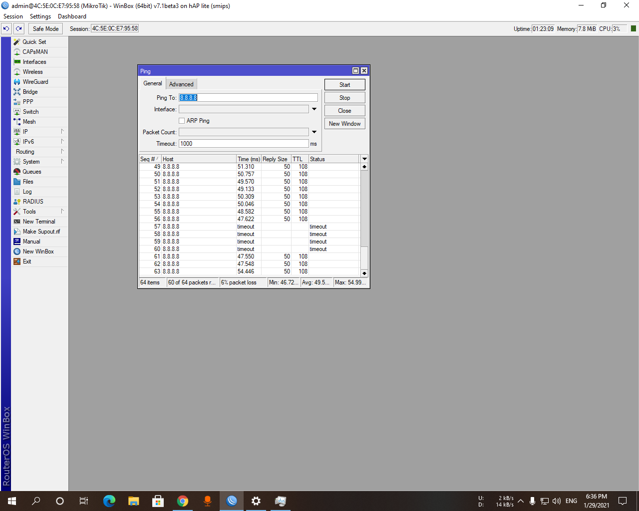

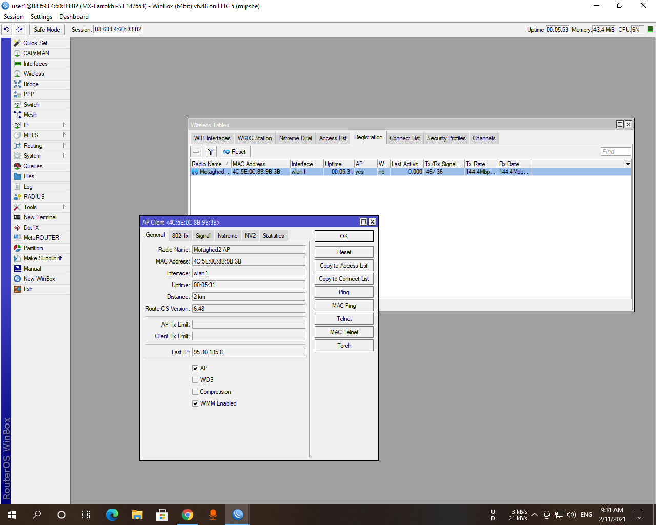

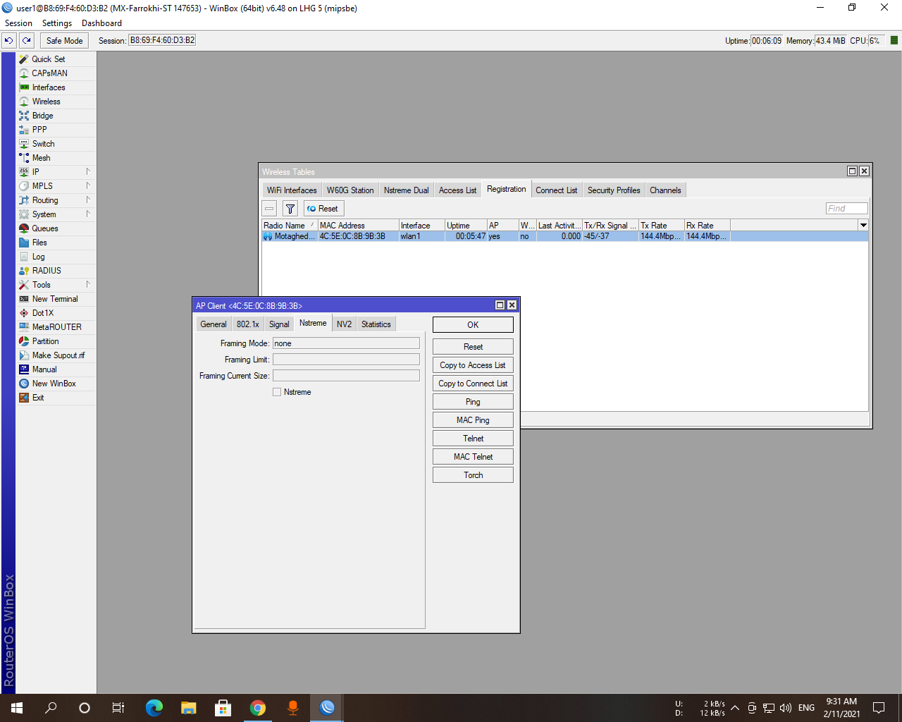

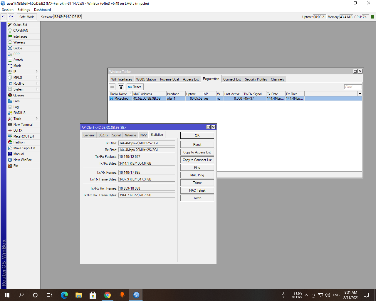

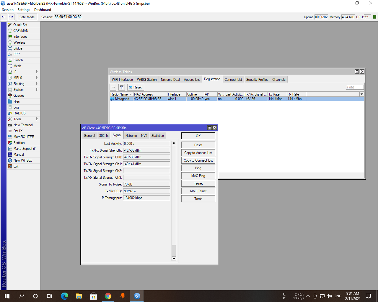

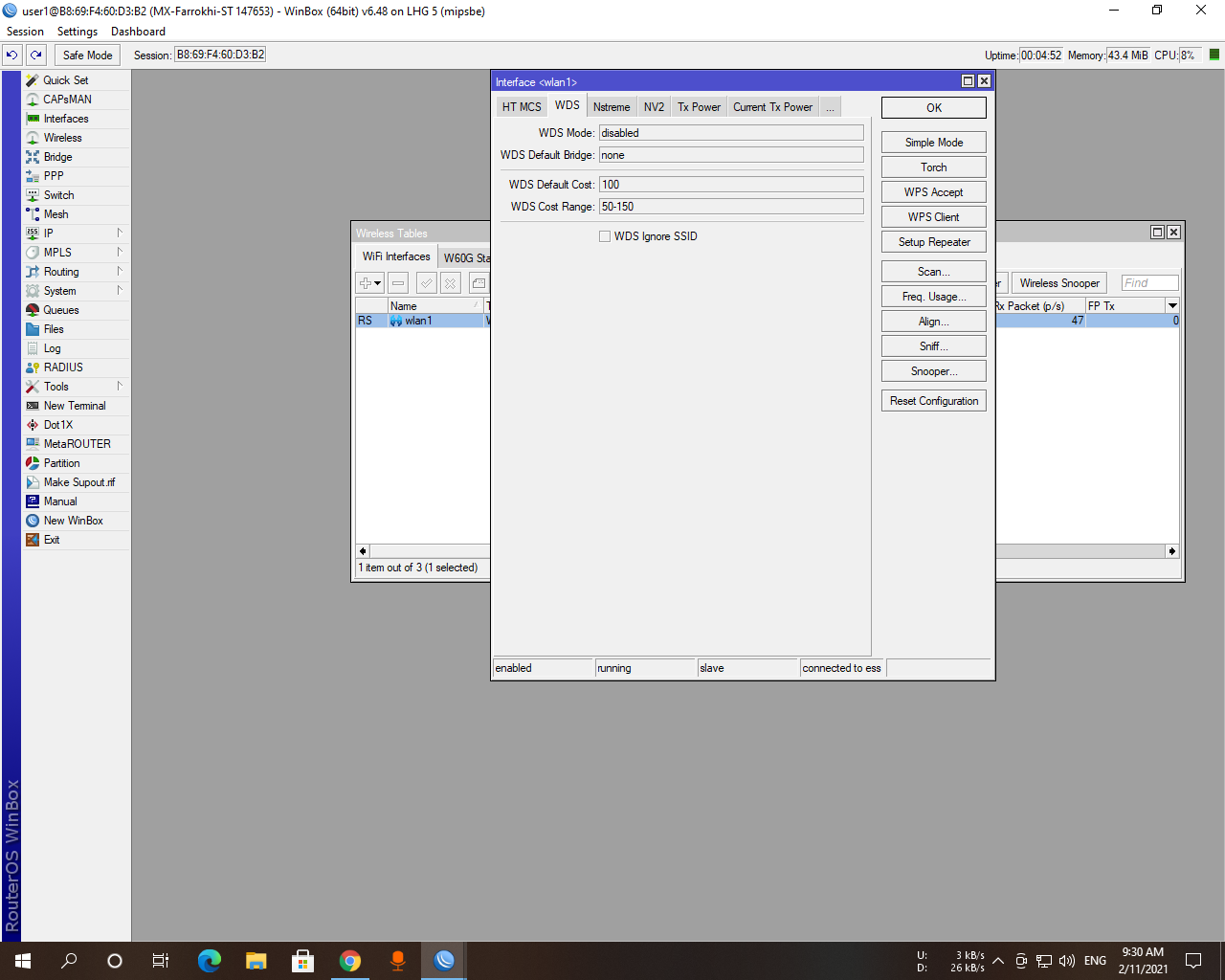

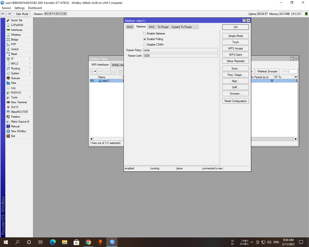

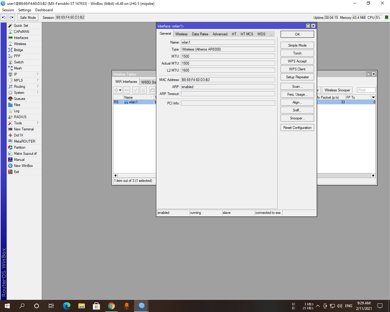

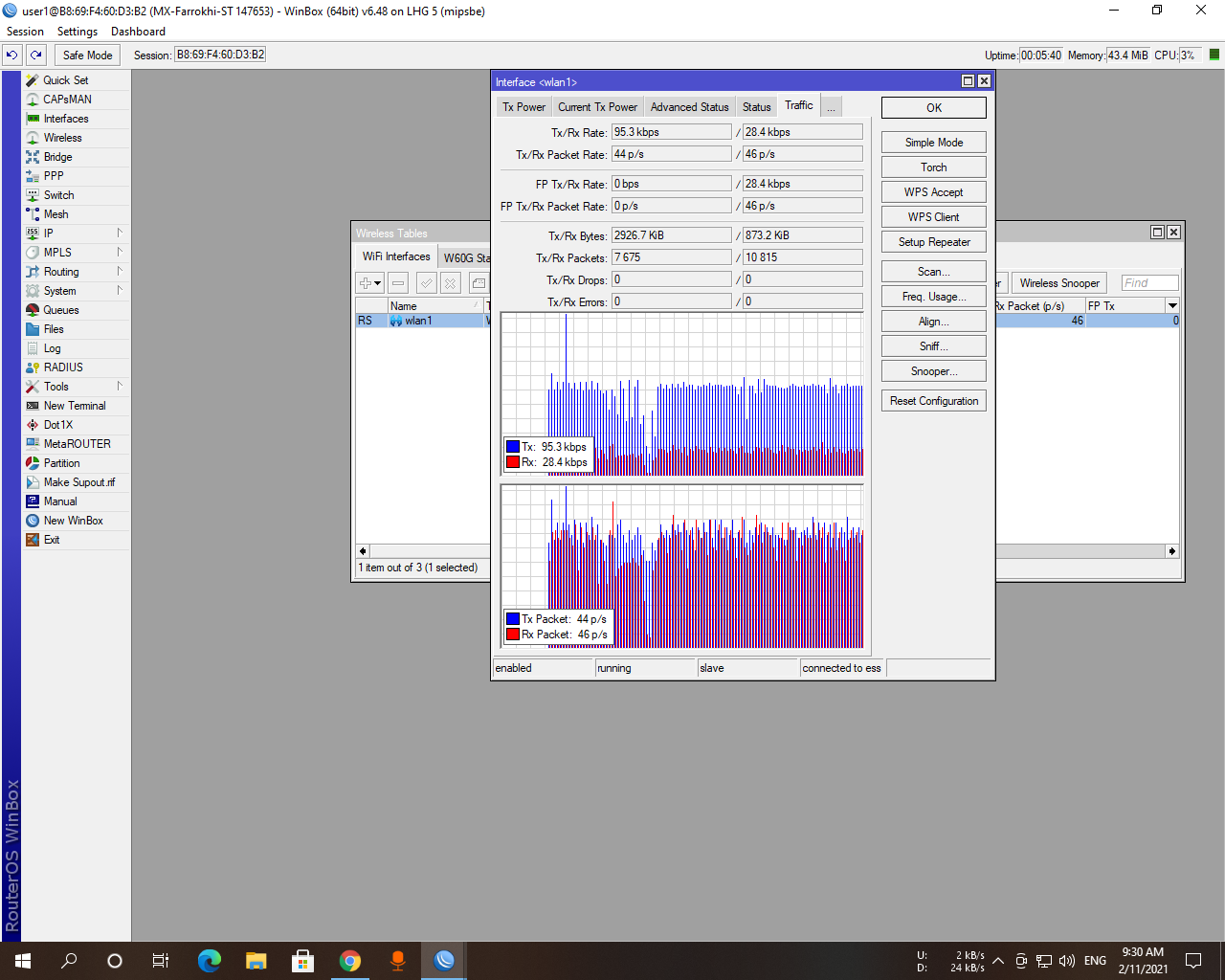

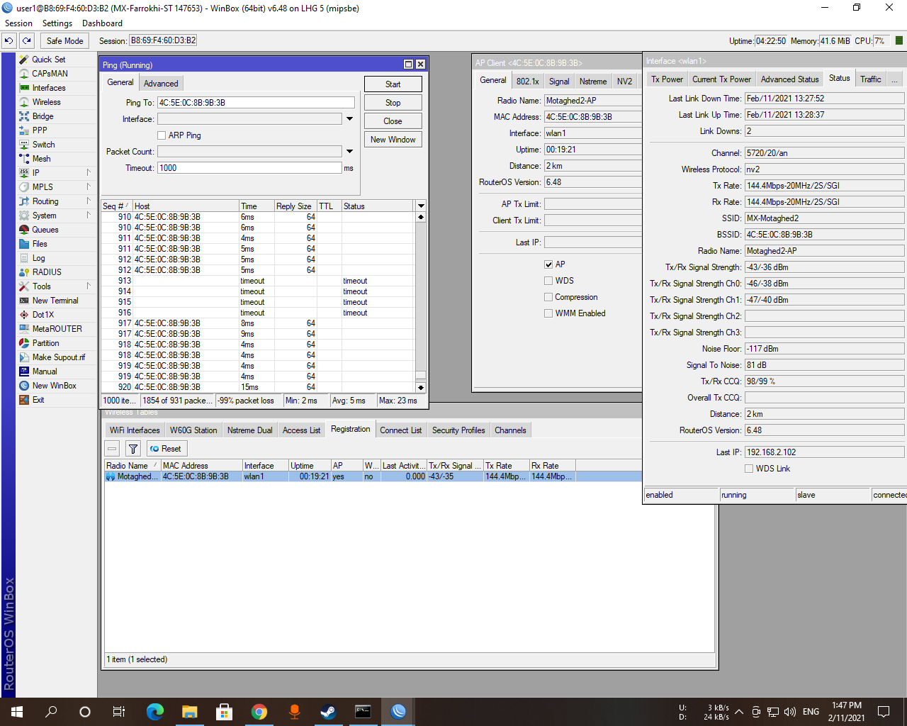

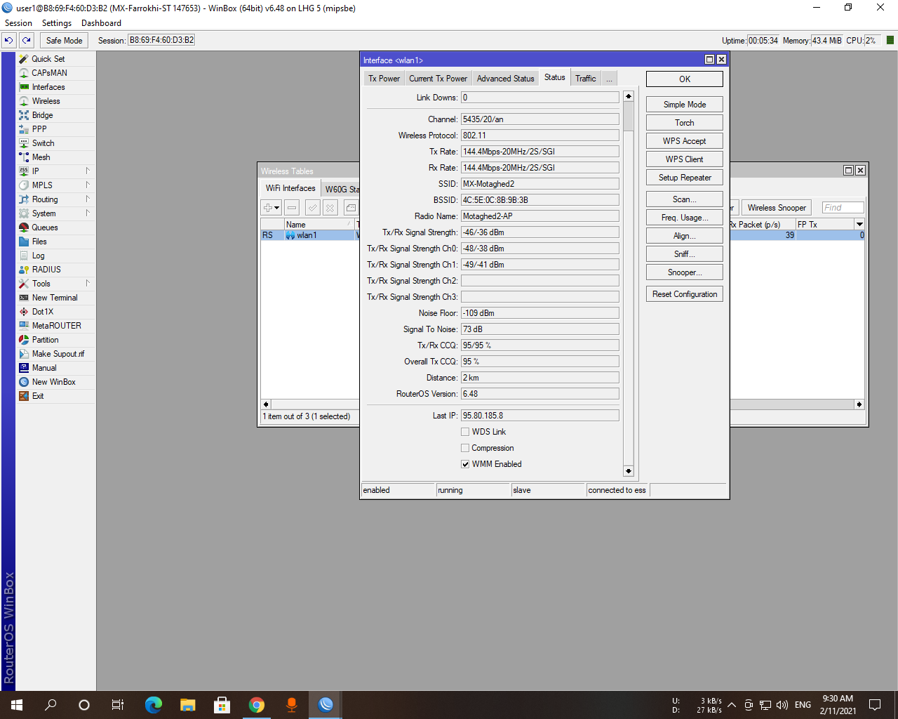

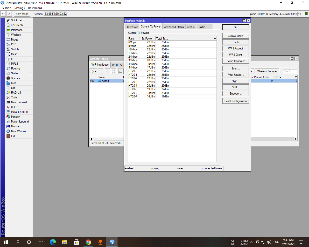

My radio wireless is LHG 5 and ISP radio is QRT 5. The connection is PTMP, there is 3 other clients connected to that QRT 5. There is a weird problem that happens every few moment and it’s so annoying for me. every few moment( 2 minute - 10 minute) I get a complete disconnection for 3-4 second and it’s so annoying because it interrupts every kind of task (Voice Call, Online Game, University online course, live stream or video, Streaming by myself). I called ISP many times to solve this problem, they did everything they can to solve it but they couldn’t succeed. Also we checked everything together (Me and ISP support) but we couldn’t understand what is the reason of this problem. The 3 other client are industries and they get closed after 15 PM, so after that time I’m the only user who uses the internet and other 3 client device stay as idle mode (They just stay online and don’t use any internet). So ISP asked me to research about it. They are ready to set any configuration I say to solve this problem because they have no idea what’s the reason of this. Thus I decided to ask you for help, I can provide any detail you want to solve this problem.

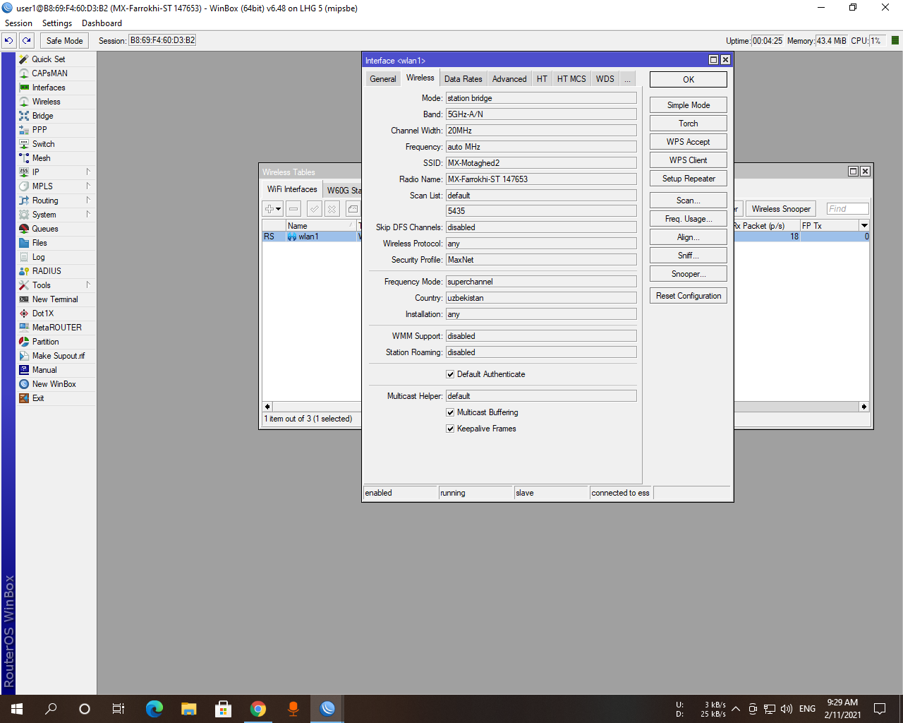

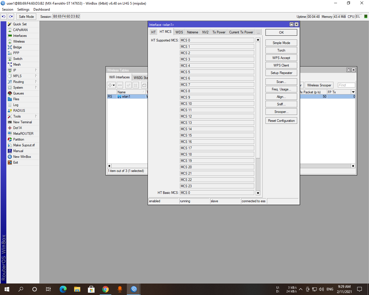

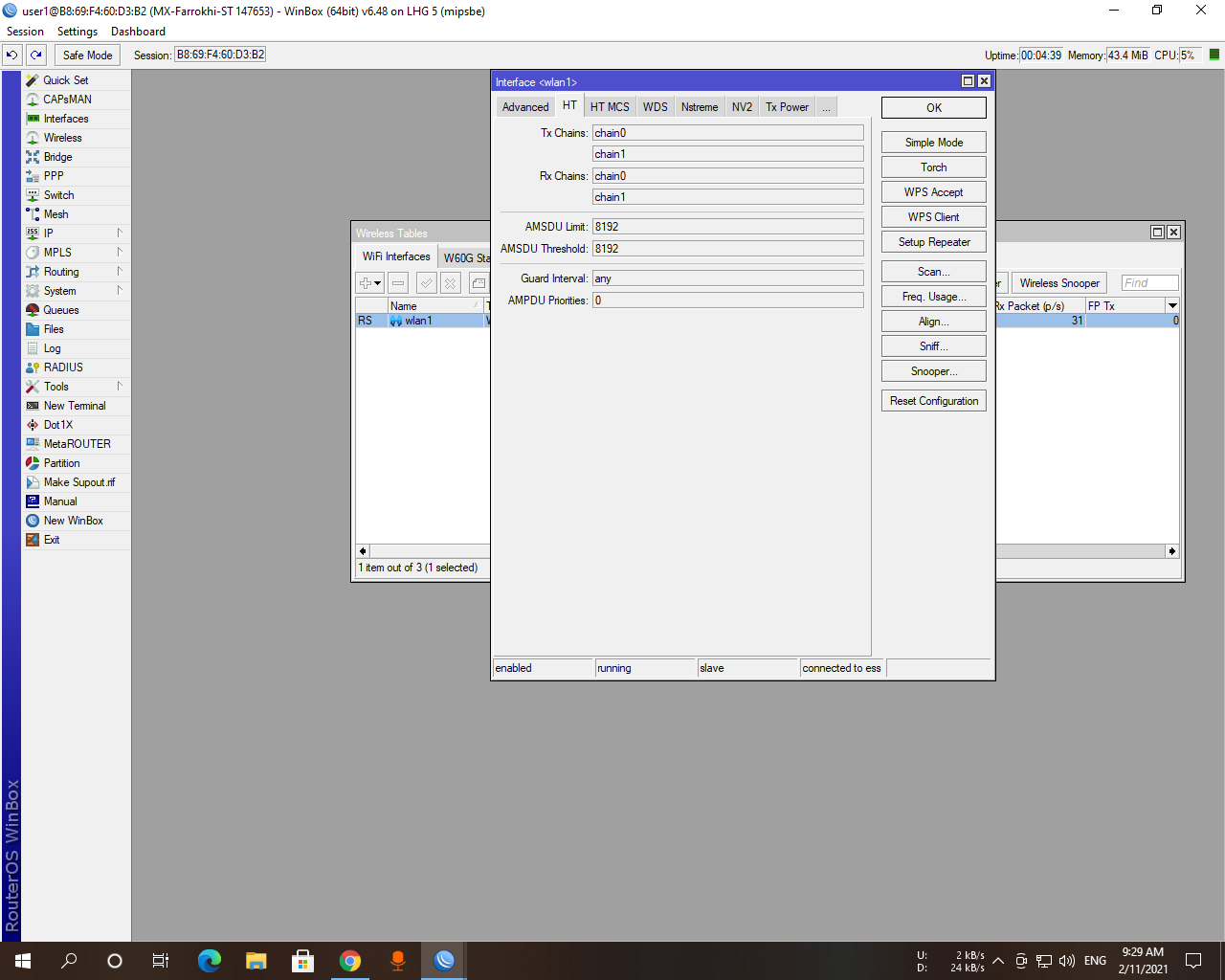

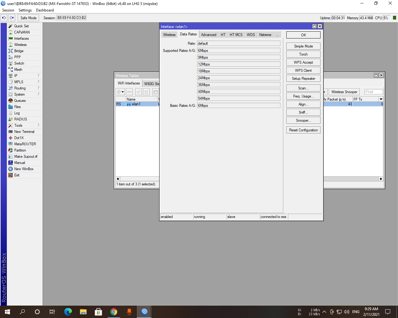

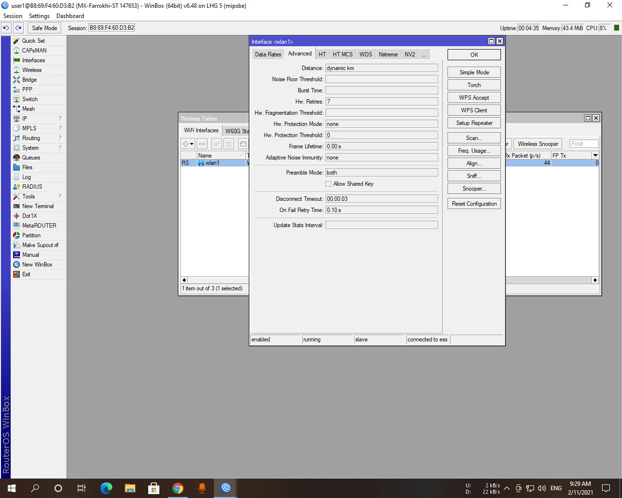

These are the settings of my LHG5.

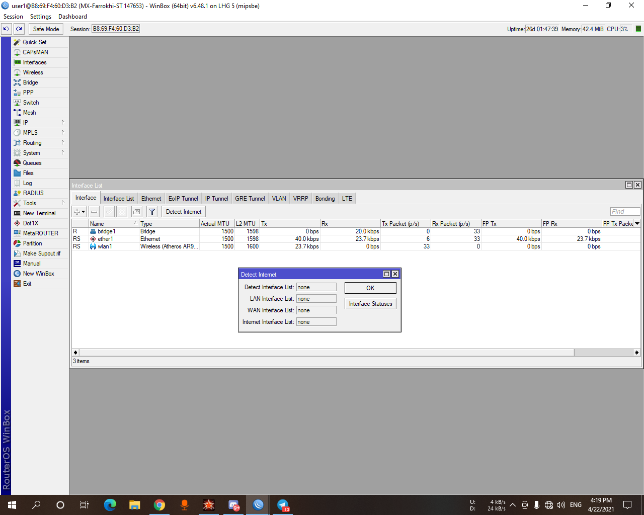

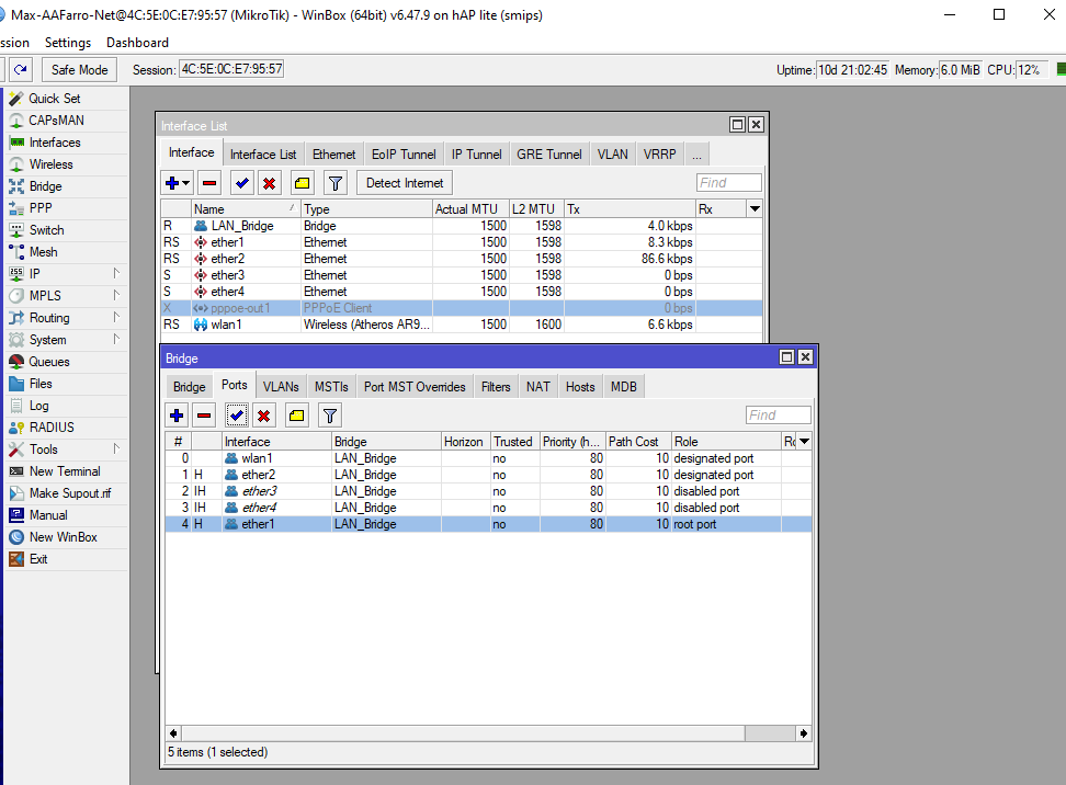

Just as a blind shot until you can arrange that, press [Interfaces], and in the “Interface List” window that opens, press the [Detect Internet] button just above the table on the (Interface) tab. Post the screenshot of the window that opens.
I can’t have access straightly to wireless device, so I have to disable Internet first. I wonder that can I have access to my LHG 5 through my hAP Lite with online internet?
It is hard to say as I don’t know the complete setup. The LHG5 may be working in bridge mode an have no IP address, or there may be a management IP address assigned by the ISP. When you connect your PC to the hAP lite, you can see only the hAP lite in the neighbour list in Winbox because the hAP lite acts as a router and thus the LAN and WAN are not the same L2 segment, so the discovery protocols cannot traverse between LAN and WAN.

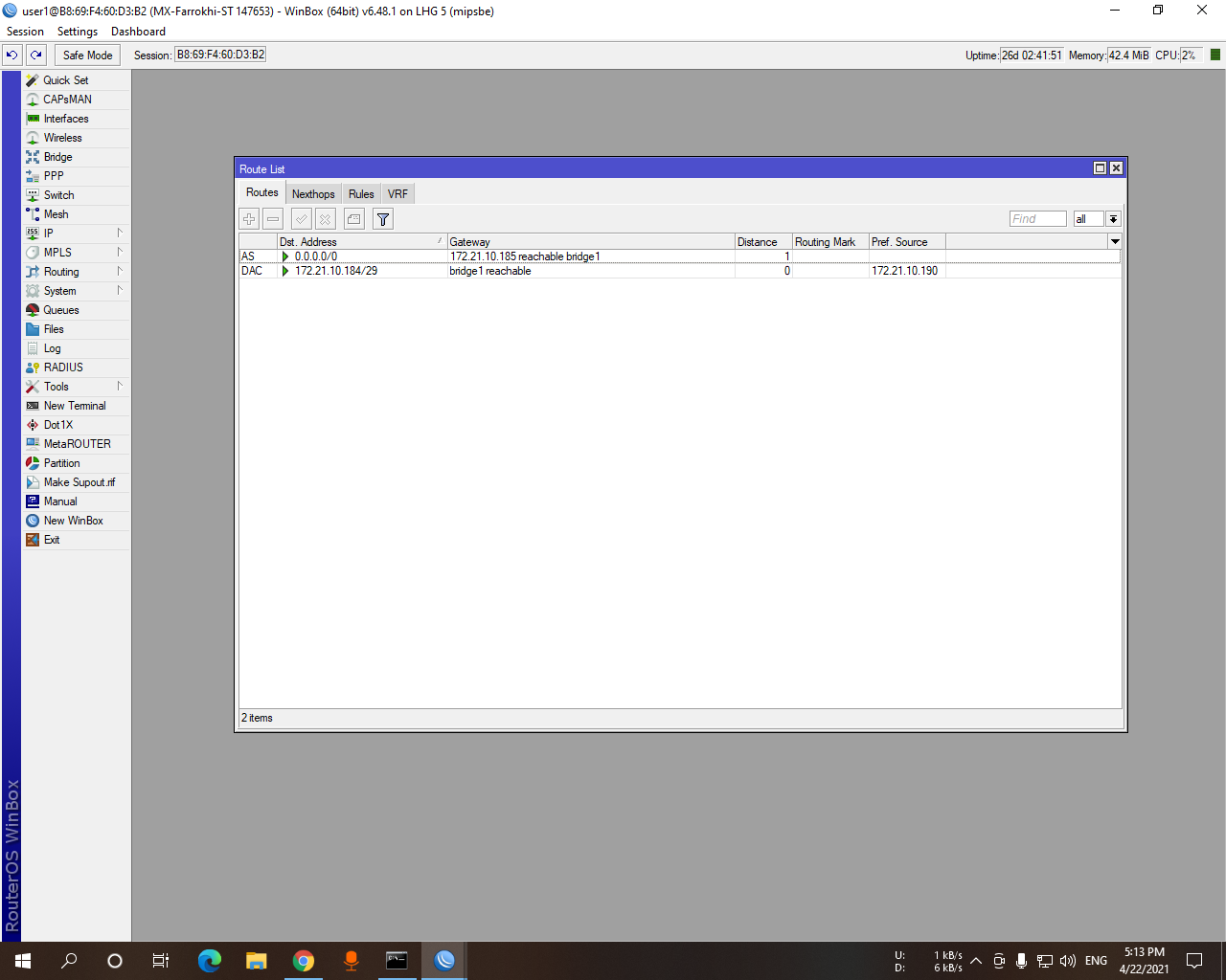

To find out, on LHG5, go IP->Addresses and post the window that pops up (if the IP address is a public one, hide it in the picture).
Then, go IP->Routes and post that window.

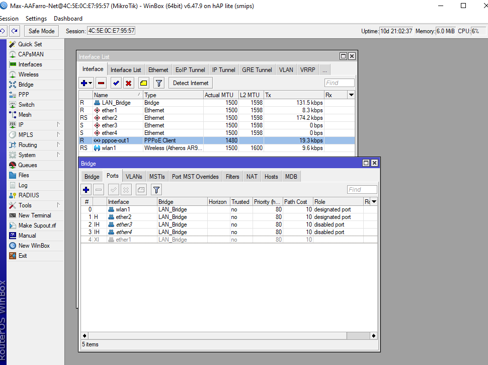

And post the text export of your hAP lite, I suppose that device is your own one so you can do the export on it?

You may want to remove the script part from the configuration export (edit the post, remove the file and re-post it without the /system script and all the lines following it) and change your password to the DynDNS service. It didn’t come to my mind you could have something like that in operation. I’ll continue regarding the original topic later.

To the original topic: given how the two Mikrotik devices are configured, I doubt the ISP network allows the customers to access the LHG5 using its IP address. The PPPoE connection from your hAP lite is terminated on some of their central routers and there is probably a firewall rule or a missing route to prevent customers from accessing the subnets the ISP uses to manage their delivery network. And you cannot configure an IP address from that subnet on ether1 of the hAP lite because the subnet is really small so you could get in conflict with some other customer (since there are 4 customers in total, there’s a single free address in that /29).

As your initial screenshots show that you ping the MAC address of the AP from the LHG5 itself, it should not be a cabling issue, except if a powering one. Do you know how long is the Ethernet cable from the PoE injector to the LHG5, and what is the voltage of the power supply used to feed it?

The way you describe it, it sounds as an issue with the wireless protocol where some of the other clients on the same AP is sending when it is not supposed to, interfering with the signal from your LHG5, or the AP not allowing your STA to send for quite a long period of time. This is something that can only be debugged the way I’ve described before, i.e. using a third radio to passively listen to the wireless traffic and then analysing the captured communication, and it needs an experienced WiFi specialist to find the issue and identify the guilty piece of equipment.
