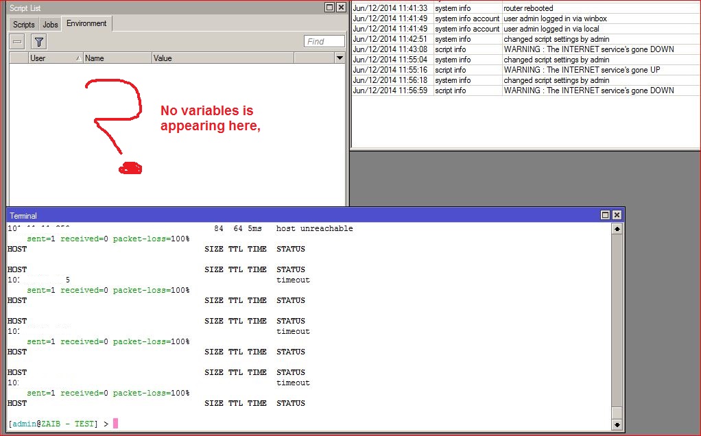

I am facing following issue.
After the script runs, it do logs, but no variable is displayed in VARIABLES section of the script.
The previous version of the script which check s only single host was making variables fine.

UPDATE: I tested the same script on another RB, and it worked fine. So probably something is wrong in test RB (x86 version)
