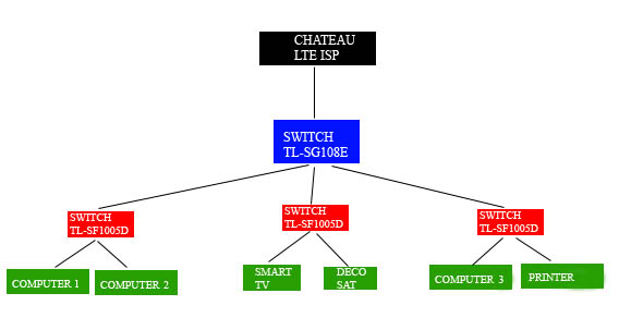

More data. I have a LAN at home. The router connects to the internet to a Tp-Link TL-SG108E switch, as a central switch, and 3 other secondary Tp-Link TL-SF1005D switches are connected to it. 2 computers connect to that TL-SF1005D, from there the network goes to the TL-SG108E and from there to the Chateau. In turn, 1 Smart-TV and 1 SAT deco connect to another TL-SF1005D and from there the network goes to the TL-SG108E and then to the Chateau. This LAN runs in a CAT5e wire, on the living floor of the house.
Downstairs, in the garage, I have a third computer and a printer that connect to 1 TL-SF1005D switch, from there it connects to the TL-SG108E via CAT7 cable. The LAN seems to work correctly, with the TP-Link and Huawei routers I always have a perfect internet connection, without cuts.
Everything works correctly on the home floor network, internet connection at all points (2 computers, smart-TV, deco SAT …), but the problem is when I connect from the garage computer. That computer seems to connect well, I do a speed test and sometimes it works well but other times it completely loses the internet connection, although the router continues to give the appropriate signals. Sometimes the internet connection is even lost from the computers in the living floor like if the garage computer blocked the connection or produced some kind of interference. If I don’t connect from the garage computer, the network is always fine. If I use the Tp-Link or Huawei routers the entire network, including the one in the garage, connects without problems to the internet.

This is my LAN.
Internet connection in “computer 3” fails. I start windowsm it seems to run ok. I make a speedtest of internet connection and runs ok. I retry and retry and retry the speed test and it fails in some momments. As soon as the failure occurs, it is almost impossible to recover the internet connection. However, the LAN connection continues to work because I connect via Winbox with the router from computer 3.
