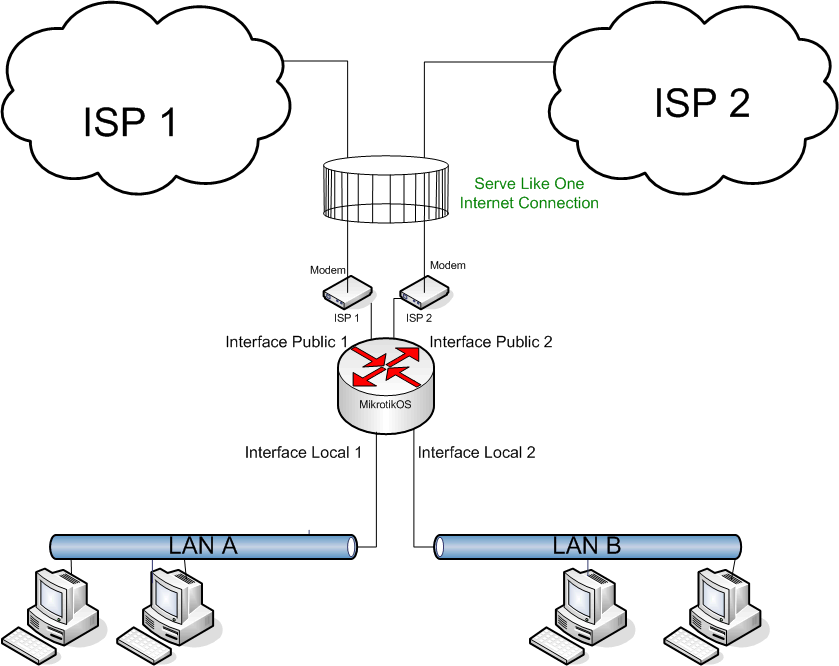

I would like to configure gateway “Load balancing”. I mean 2 different internet connections, connected to Mikrotik that serve like one (like on fig).
Please, may you help me with configuration, suggestions or any available guide.
P.S. 2 Internet Connections have different bandwidth limitations.
Thank you in advance

Bledar glad to help u :smiley:. Try this one NTH, and do not use ECMP cause u will have problems later. Here u have the wiki page:
http://wiki.mikrotik.com/wiki/NTH_load_balancing_with_masquerade_(another_approach)
Regards.

I have a fogginess regarding gateway load balancing with NTH feature:
Does ip proxy, works with nth load balancing?
Is it a good choice to use NTH with 2 different connections (one connection use shared bandwidth, unstable bandwidth)
Thank you for reply.
Yes proxy works as normal, and by the way, i have been using NTH for these past 2-3 months, with one dedicated and one shared connection, and its working quite good :smiley:.
