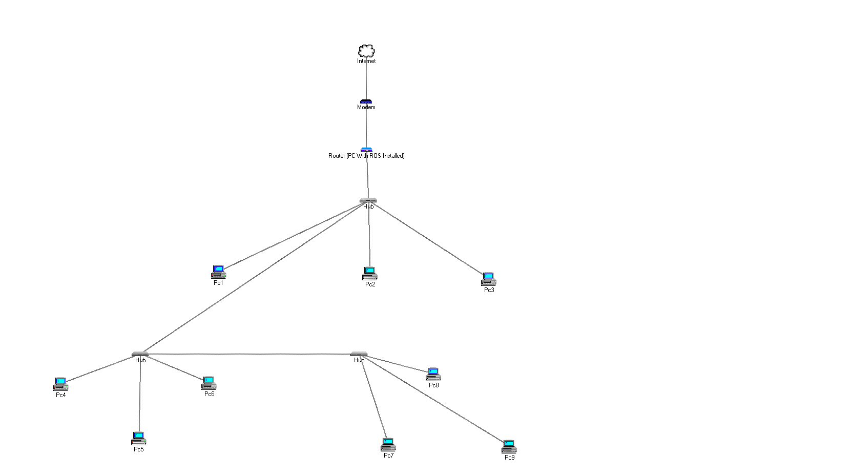

When router switch on it dynamically assign ip from modem like 192.168.1.77 with dns 202.99.132.240 .
1 . When any client turn on there PC they automatically get an ip by dhcp server.like 10.0.0.2 for Pc1 , 10.0.0.3 Pc2 , 10.0.0.4 Pc3 and so on,but they unable to use internet.
2 . when they use there login and password to connect for use the internet then it automatically get another ip,
3. i want to share three rate limits 512Kb , 1Mb and 2Mb, client with different limits get different ip ranges, like 192.168.77.2 for 512 , 192.168.88.2 for 1Mb and 192.168.99.2 for 2Mb.
In pic it shows 9 PC so PC 1,5,8 get ip 192.168.77.2,3,4 and so on.
PC 2,6,9 get 192.168.88.2,3,4 and so on.
PC 3,4,7 get 192.168.99.2,3,4 and so on.
4 . i want to add 1 more PC as my media server that my clients can access data from this PC by daily data limit.but it’s can only accessible when they connect there login:password.
5 . How to add Queue for clients?
So what will be it’s complete procedure by command?
