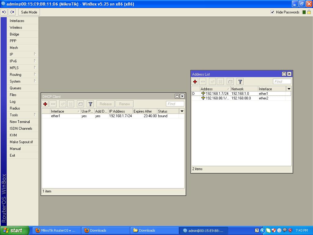

My hotspot settings is shown below together with a relevant screenshot of DHCP server.
I have also switched interfaces but still nothing works.
