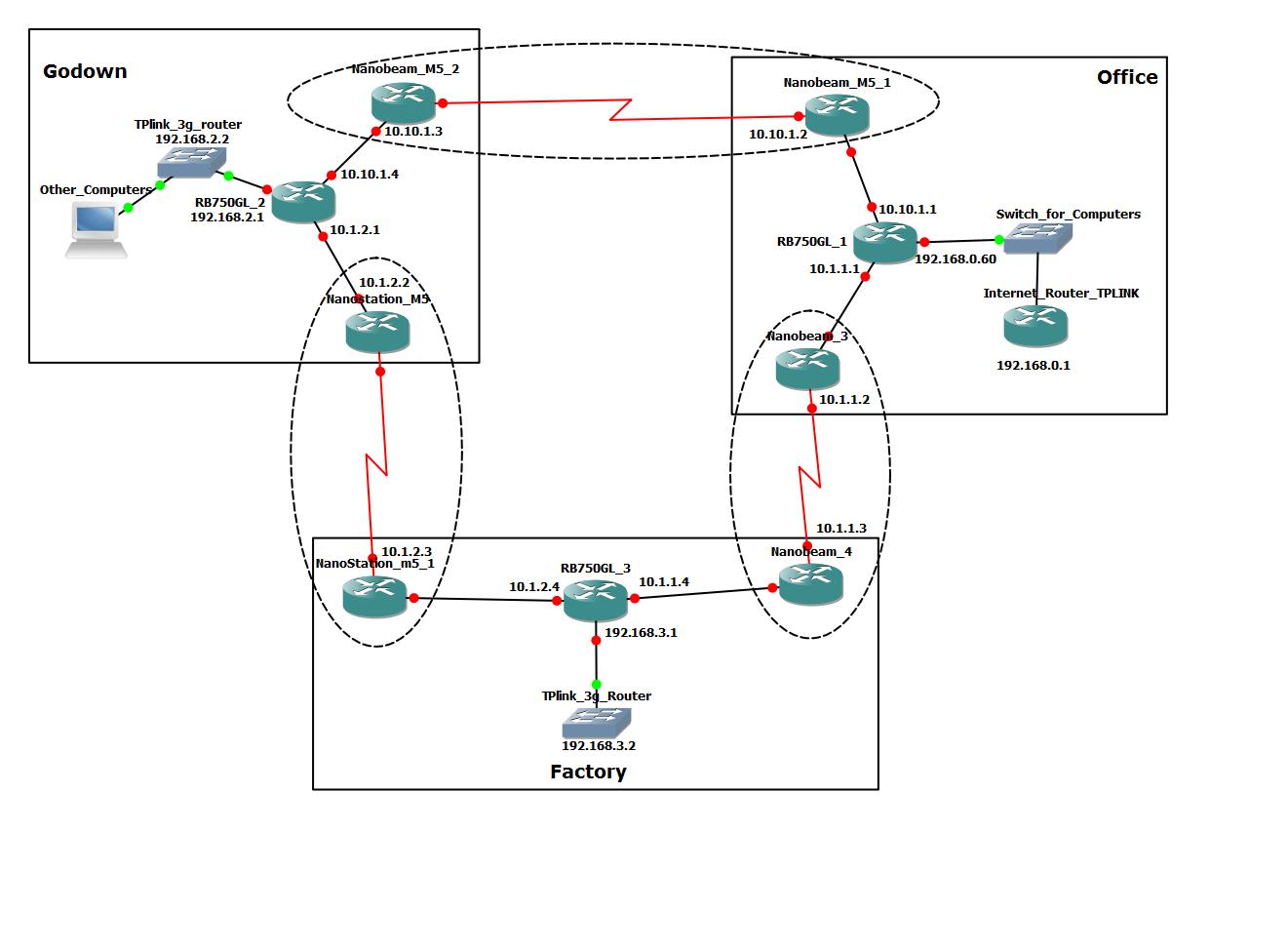

I have a site (Site-1) which has IP address series of 192.168.0.x.
And another site (Site-2) whcih has series of 192.168.2.x
Both sites are connected via UBNT wireless equipment. I have seperate internet connection on both sites. Site-1’s internet
router is 192.168.0.1 and it is connected to RB750GL (192.168.0.60).
Site-2’s internet router is 192.168.2.2 and RB750GL is 192.168.2.1. I am also attaching a picture so that you can have a
better idea. I am able to route between the sites and easily access the computers of either site.

Given the diagram you provided, you should never have to change the route on anything other than the 750 at either of the remote sites (every computer, printer, and other device at each site should be using the local RB750 as the default route.
The better option, would be to implement OSPF. Each router would advertise it’s connected networks, and the router at the office would also advertise a default route.
If the Office-Factory link goes down, the Factory router will automatically re-route traffic through it’s connection to Godown.
If the Office-Godown link goes down, the Godown router will automatically re-route traffic through it’s connection to the Factory.
Check the Mikrotik OSPF Manual for details on how to implement it. It would take 5 minutes for someone with OSPF experience to set up. Without experience, it shouldn’t take much longer than that if you work directly from the OSPF Examples.
The only thing I would emphasize, is the use of loopback addresses, which can help avoid a lot of headache, as it will always be available, unlike addresses attached to physical interfaces. Each router must have a unique address. I’d use 10.0.0.1, 10.0.0.2, and 10.0.0.3. Use these loopback addresses as the router-id. They are also useful as the management address.
