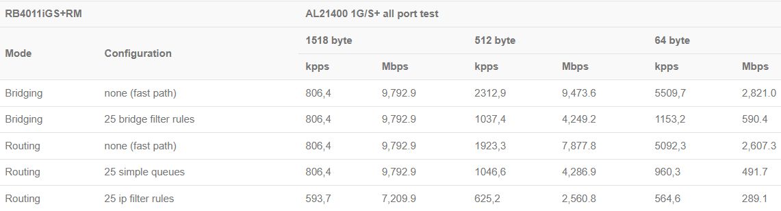

As you see max routed speed with 25 rules could reach 9 Gb so 1Gb is easy-peasy for RB4011 if only you do not apply to many and “heavy” rules.

About the devices performance, the usual reference on Mikrotik test results is routing Mbps with 512 byte packet and 25 ip filter rules:
L009UiGS-RM ← 323.6 definitely not enough power
RB3011UiAS-RM ← 836.0 slightly less than needed
rb4011igs_rm ← 2,560.8 more than enough
rb5009ug_s_in ← 3096.2 more than enough
These latter 2 have the same list price, the 4011 is Arm 32 bit (older) but has two more ports, the RB5009 is a more compact, more modern (Arm 64) but has only 8 ports.
