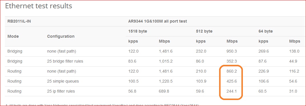

I have a quick question I was wondering if I can get help with, I purchased a router model 2011UiAS RM and I have 600mbps internet speed in my home but when I connect my modem to port 1 and my computer to port 2 I can only get a max of 425 mbps. The router was removed from the box and plugged in stock. Do I need to configure anything to get my 600mbps speed? Please help.

As per the below diagram the best one could hope for under ideal conditions is around 860Mbps, under 25 Filter rules its down to about 250 Mbps and somewhere between the two 42 5Mbps. Thus your results are exactly as expected and what most get out of the router.
cue the usual liars that come on that boast about 1gig speeds they get, just ignore them!

rb2011 is almost a decade old device, no home network can get over 400 mbps at that date

Using the very same test data source anav gave above, you’re likely to top out around 270 Mbit/sec.
