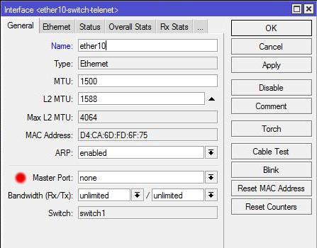

Have you ether10 in switch modus?
You must set his masterport to none
Doubleclick on interface ether10
See attachment (the red dot)
Make sure that Eth10 is not a slave of any other port(it should be a master port)
Thanks!
I had to remove slaving from port 10 (and also remove bridge).
Now it’s ok!
