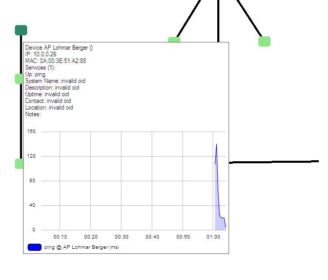

After upgrade i can`t see any description of my network moduls on the maps!
Any Idea?
THX

I have this exact same problem.
Note that it only occurs when I connect to my remote Dude server running ROuterOS 3.17 and the independant Dude 3.0 package.
If I use the Dude client 3.o on my pc and connect to local server then things show up ok.
Any tips?
I also note that when trying to edit a device image no image files are listed on the dude server.
Rgds
Alex
So, by the fact that I have the invalid oid error as well as apparently missing svg files for the icon images for devices, is it possible that these are a: either not present in the package or b: deleted / corupted when the install was done.
I Should explain that this machine has been progressively upgraded from 2.4.4x and then was running on 3.11 for a lon time and I have just upgraded to 3.17 ROS and then upgraded the Dude package to the v. 3.0.
Help appreciated.
Alex

It looks to me like the MIBS for SNMP are missing and also the SVG files that make the graphics work are missing too…
Is this a bug?
Rgds
Alex
Just working this through with the guys at Mikrotik.
Running the command /system check-installation gives the following output, which confirms my feeling that it was missing mibs and images.
So, I am going to remove the Dude package and then re-install it. Hopefully then check-installation will come back clean and dude will work.

So the reinstall of Dude has worked.
I removed the dude package, then downloaded it afresh from the mikrotik website, and installed it again.
My network maps are now working properly.
