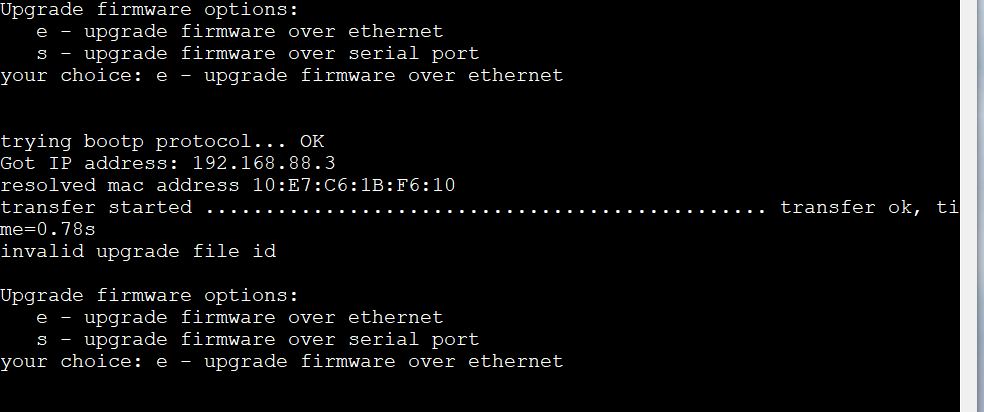

I’ve tried to upgrade to ROS 7b5 my RB1100AHX2 with no success. And then I’m not able to do netinstall. here is shot from RS terminal:
Board info:
Board Info:
Board type: 1100AHx2
Serial number: 574104A9371D
Firmware version: 6.46.3
CPU frequency: 1066 MHz
Memory size: 2048 MiB
NAND size: 128 MiB
Build time: 2020-01-28 10:56:39
You want to boot over ethernet, not upgrade firmware. Firmware is like BIOS, that’s not the ROS/netinstall.
In menu select boot device and change it to boot from ethernet only. Then do the netinstall and after it set it back to boot from NAND.
