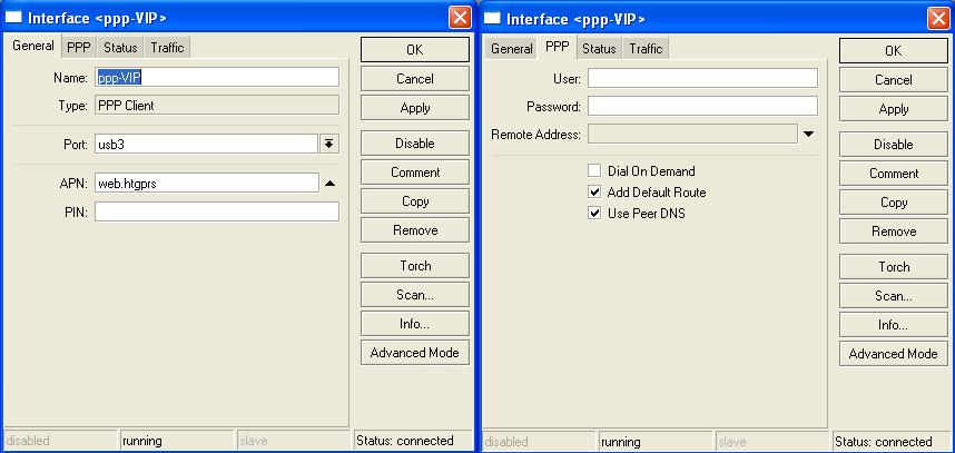

Sorry for the long delay.
The image is attached (winbox example)
EDIT:
I just realized what you are asking.
The multiple apn setup here is meant to cut the work on changing scripts when i have to change my GSM provider. The APN itself you have to enter manualy in the PPP connection. The script reads which APN is in use and then changes mail server so the scripts can send mail.
