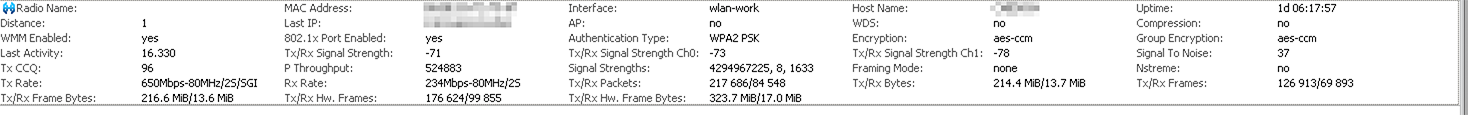

I have a few old iPhones running iOS 16, if battery was 100%, and I leave it unplugged and screen turned off, no apps running, I’ve seen uptime upto 8 hours on MikroTik AP’s registration table.
Never seen them dropping the Wi-Fi during deep sleep, unless power/battery is very low.
Normis I like you and MT but thats not true...android phones dont disconnect from the AP if display is off. How can we got msgs from Viber, Whatsapp, Messnger…etc during the all day?
My phone has over 1h uptime in my AP (Ax2) now and his display is black most of the time.
99% of modern day Android OS/iOS devices don’t disconnect, i.e. if you check registration table on the AP, they remain connected, even during deep-sleep mode on Android devices with root.
What they do is throttle the performance profile of the wireless chip and rate-limit certain traffic on layer 3, example you cannot ping (ICMP) an iPhone that’s in sleeping state, but you can send a text over IP such as WhatsApp or iMessage and it’ll get delivered in few seconds. Polling runs every few seconds.
