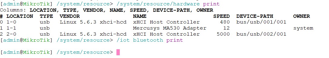

Tried a MERCUSYS (TP-Link) MA530 and it's not recognized (ROS 7.20.4 and 7.21beta8).
It's strange, it should be very similar to the TP-Link UB500
