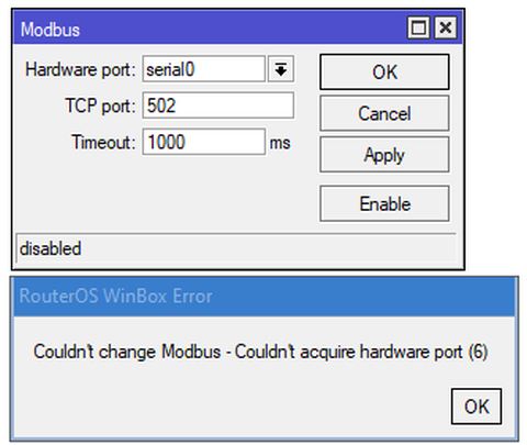

When trying to activate the Modbus TCP, it requires also to have some serial-connected device on the Mikrotik.
How would I enable ONLY the Modbus TCP?? See attached screen capture.
Looking into next 7-beta version: iot-7.4beta2.npk has no help on this matter.
Oh-la-laa! By going into terminal and disabling (the only serial port on this system (which was a console?)),
by doing this:
(help from here: https://wiki.mikrotik.com/wiki/Serial_Port_Usage )
/system/console/disable 0
/port/set serial0 baud-rate=9600
The Modbus -extension can now be enabled!
