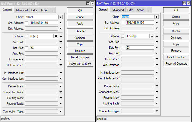

yes, exactly I set the router’s DNS as 192.168.0.33 and “allowed remote requests” but all the requests coming to the DNS Server 0.33 are from the client IP 0.1(the router) i need them to be the source IP address not masked with the router’s address. I tried using dstnat on one pc as a trial but the pc stopped resolving hostnames.

why if I use a public DNS IP in DST-NAT everything returns to normal but when I use a local IP like 0.33 everything stops?
Dst-nat could help you to forward the request to the server, and let the server answer instead of mikrotik.
But you can either forward the request to the server (needed for “regular” use), or let mikrotik answer the request (needed for you static enties), not both at the same time.
Because the local server sends the reply directly to the client (and the router has no chance to do the reverse translation), while the client waits for the answer from the router’s IP, not from the server’s.
