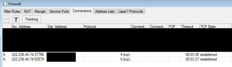

Hello all, I’m having a issue with some bot from asia. I blocked the IP address using
chain=input action=drop src-address=222.236.44.7
I also followed the wiki which shows you how to enable brute force on ssh and ftp.
This user keeps showing up in my connections tab that they have established a connection via FTP to the router.
I have disabled the ftp service on the router also changed the port number on FTP.
I had to turn off warning logs from echoing cause it was getting out of hand.
If someone could guide me to a wiki or help me please :frowning:

11:03:30 system,error,critical login failure for user Shary from 222.236.44.74 via ftp
11:03:31 system,error,critical login failure for user Shary from 222.236.44.74 via ftp
11:03:32 system,error,critical login failure for user Shary from 222.236.44.74 via ftp
11:03:34 system,error,critical login failure for user Shary from 222.236.44.74 via ftp
11:03:36 system,error,critical login failure for user Shary from 222.236.44.74 via ftp
I just redid that chain including the in-interface still connected
Your rule is wrong:
should be
chain=input action=drop src-address=222.236.44.74
sorry I forgot the 4, but I do have it right
chain=input action=drop src-address=222.236.44.74 in-interface=ether1-gateway
Do you have an allow established or related rule before your drop?
-Louis
With and without In-Interface specified same results. Try putting the rule at rule 0 of the filter rules.
