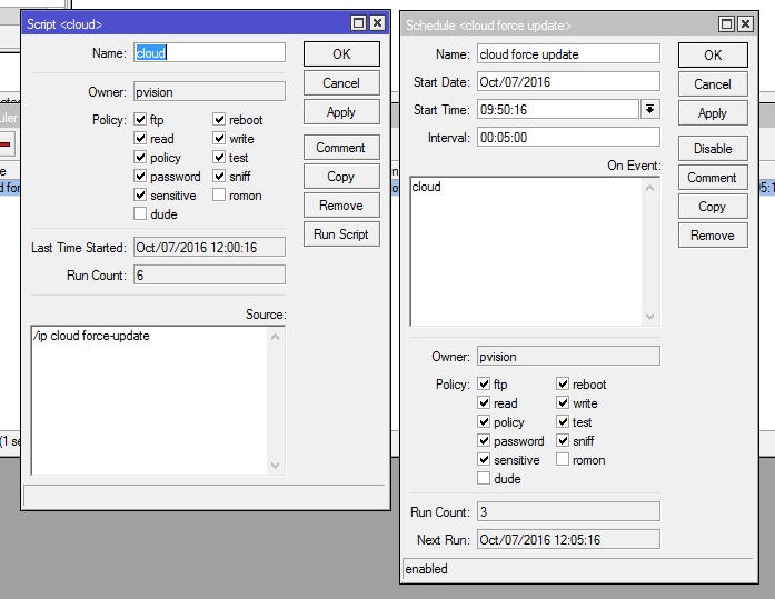

Just so you know, I had the same problem with Cloud update.
The ISP gave a device that we can’t set as a simple ADSL modem, so we have DMZ to the Mikrotik behind it.
Unfortunately the ADSL is very bad, disconnects all the time, then the Mikrotik will not update the public IP for the Cloud.
So, solution:
  1. new script
    /ip cloud force-update
  2. new schedule, every five minutes
    event: cloud
And now we’re happy, it forces update every 5 minutes.
