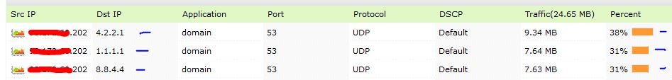

/ip dns set allow-remote-requests=yes servers=8.8.4.4,1.1.1.1,4.2.2.1
ie im using ros dns cacheing to speed up my clients (ie 192.168.1.0/24) DNS queries. But how does ROS use those 3x DNS servers?
In this thread, the answer from a MT rep seemed to be fail-over: http://forum.mikrotik.com/t/dns-utilization/93252/1
however, when i look at my traffic flow data for just DNS queries from the mikrotik (ros 6.42.7), im seeing Equal weight (ie spread across the 3x), so how does ros DNS handle if a single dns server is down? do 33% of requests now fail? (see my image below based on 16hours of data, it could just be luck that it appears to be equal weight / 33% per DNS Server of 3x , but this is why we need a solid answer)

to update everyone, i received this reply from MT support (email):
Yes, once DNS servers are responding properly, the same weight is applied.
In case one DNS server is not responding, its weight is decreased, then router check again if server is responding and weight is decreased or increased (whether query is replied or not).
So it appears (and pls correct me if im interpeting this wrong)- that if all dns replies are working, than equal weight is applied (ie 50/50 if 2x /ip dns servers= are used). If one of the 2x starts to not reply the weight becomes 100/0 %, until the down dns server, starts replying again (at which pt it goes back to 50/50% ).
(im going to test this locally, and will report back to confirm). tks
