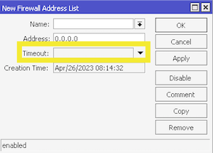

Do you mean like the image below or a timeout on the filter rule itself (ie “Src/Dst Address List”)?
Well i tried to do it both ways and found only one, on the address list dialog (your screenshot depicts).
