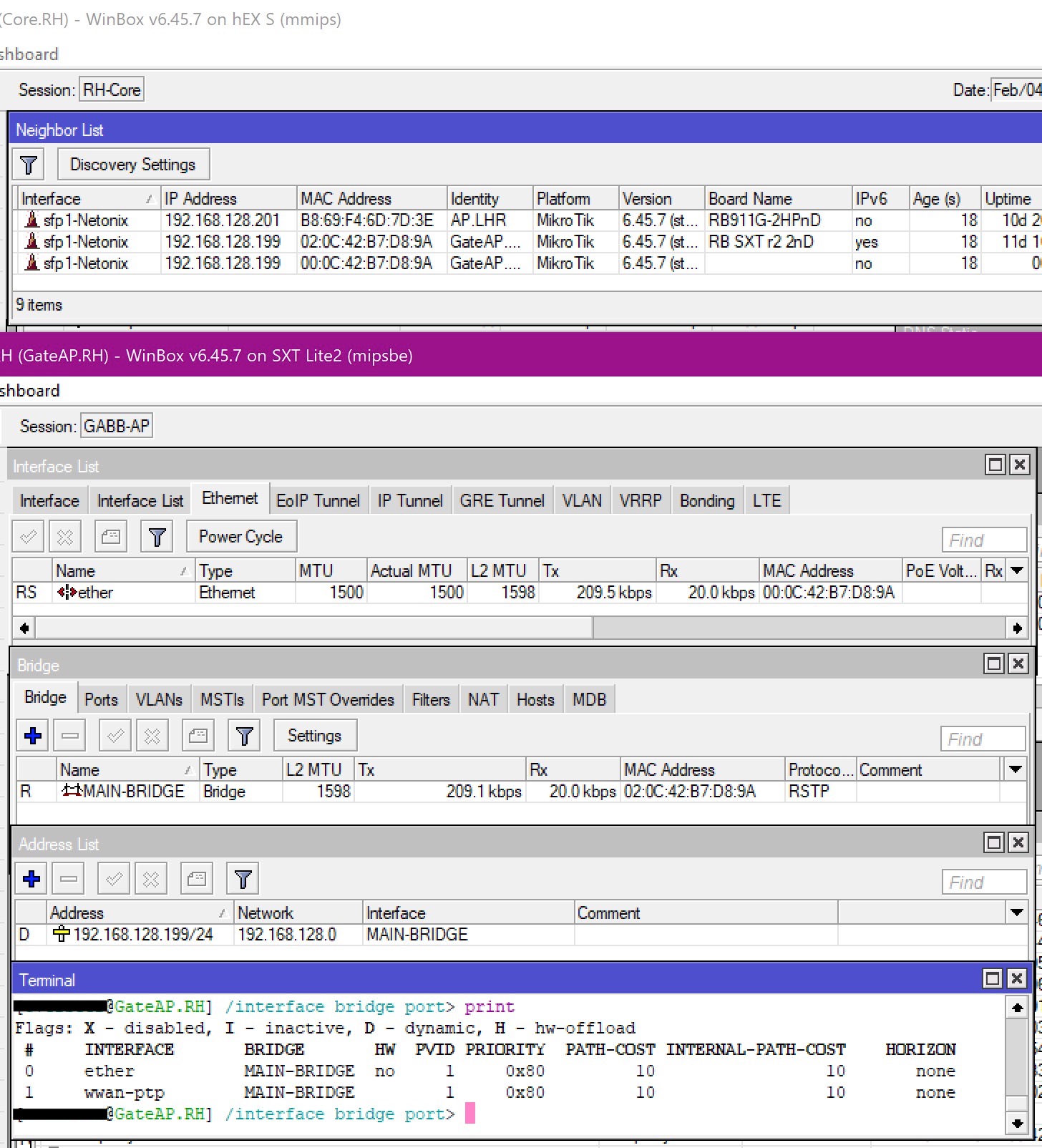

I see this behavior too, on a network established for years, one that does not have any of the addressing issues proposed, or use CapsMAN, and NEVER showed this behavior until a recent release, on or around the time of the one that changed the user password encryption method. I am confident that it is a recently introduced bug. I have not reported it since it didn’t really affect my work (I could just ignore the duplicates).
For example (see image) GateAP.RH at 192.168.128.199 is an old SXT being used as a bridge (actually a single-device AP). The ether and wireless ports are bridged together and have an admin MAC address. Previously, only the admin MAC address would show in this table (correct operation). Now, /ip neighbors also shows the ether port’s MAC address with wonky properties: no IPv6, zero uptime, and a blank board name. You can see it also does exactly the same for AP.RH. This is just wrong. Feel free to report it to support@mikrotik.com .

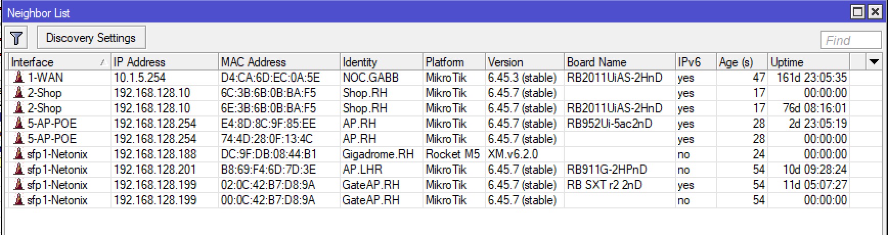

This may be an issue in the OP’s configuration, but the bug exhibits even on configurations that do not contain such an error. See image. All MAC addresses are correct, all bridging is correct, all addressing is correct, yet neighbors still show up more than once, only one of them with correct properties.

Come to think of it: on my 6.45.7 I don’t see any neighbour duplicates. However, I do see spurious entries such as one with MAC address shown as “00:00:00:00:00:00” or entry which actually belongs to a linux host running winbox (under wine) I’m connecting from. Those spurious entries seem to disappear from the list after a while (100+ seconds).
So I agree with @macsrwe that this phenomenon is not caused by configuration on remote devices, it’s a bug in winbox and the bug presents itself differently on different winbox versions.
Winbox 3.20 (both 32 and 64 bit versions) behave as written in previous paragraph. Winbox 3.18 (32 bit) doesn’t show the all-zero-MAC entry, but shows the winbox-running linux as well. I have older versions of winbox as well, but those are not compatible with recent ROS.
Seems that it’s winbox which triggers these spurious entries. If I connected to RB via CLI and checked neighbour list there (/ip neighbor print detail), I could see all those spurious entries as well. After I closed all winbox clients, those spurious entries slowly vanished, some after 3 minutes or so.
