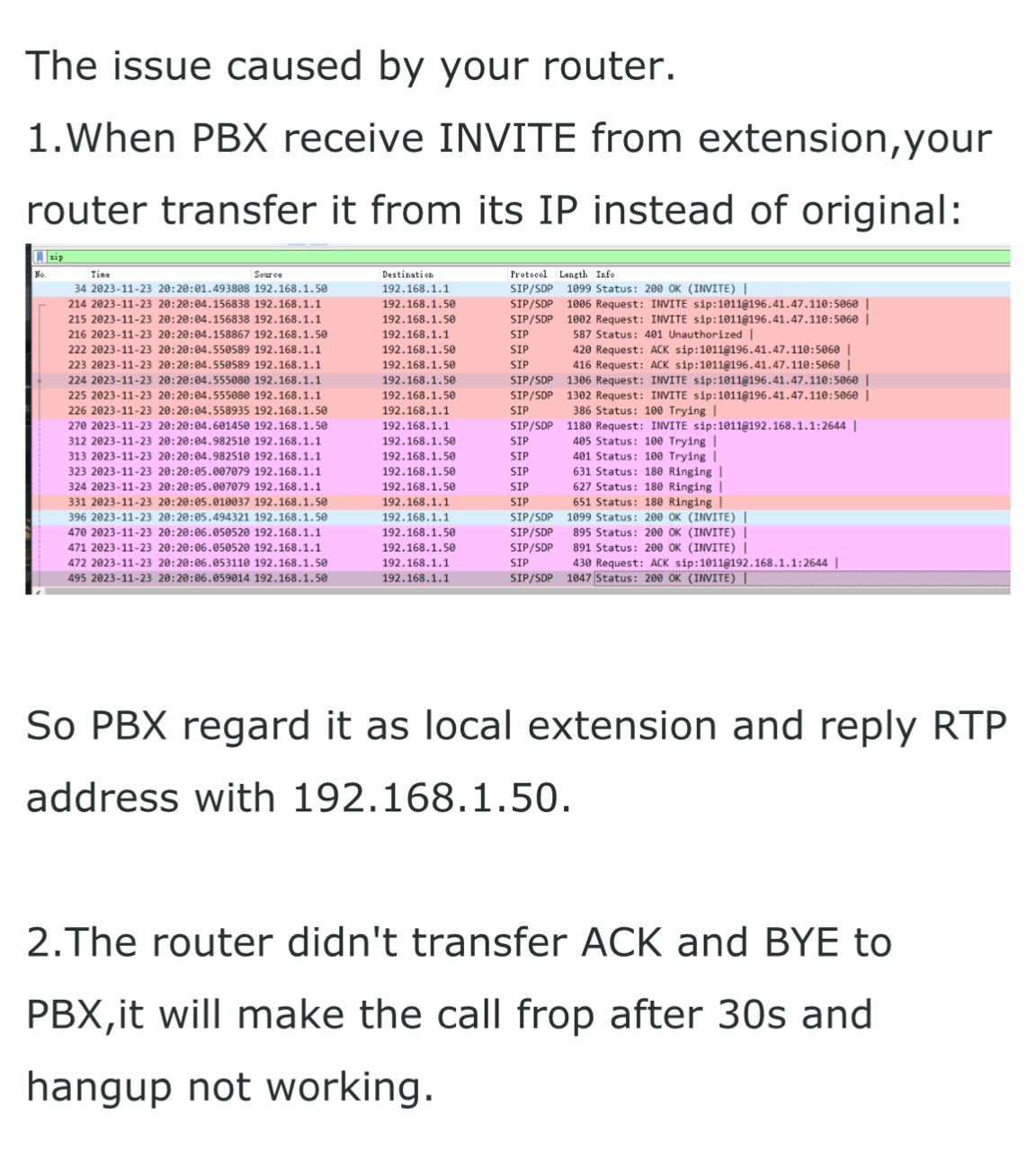

the issue we are facing is the packets are dropping as well as for SIP. after contacting the yeaster support, they suggest we look into mikrotik router configuration.
atttached are the screen shot of the log. any help would be appriciated.

Invite from outside should come with public IP not private IP of mikrotik.

You can try to disable the “SIP Helper” in IP > Firewall > Service Ports, which is equivalent the “ALG” in other routers. (Or if ALG is required — which is unlikely — then make sure it’s on the right ports — but with ALG you may just need to allow SIP port to router, likely without an dst-nat of port)
