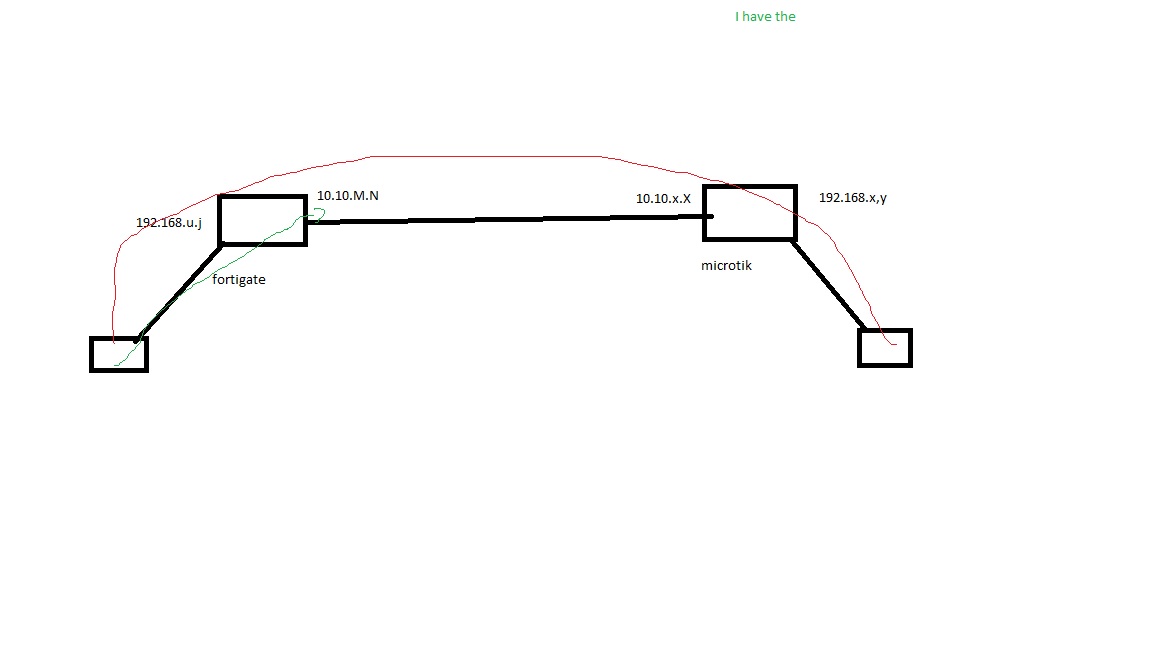

I have ip sec connection set up with fortigate
the tunnel is up
and running but when I am sending traffic from microtik to fortigate I can see the packets going out from fortigate ipsec interface but 0 recived packets from microtik side

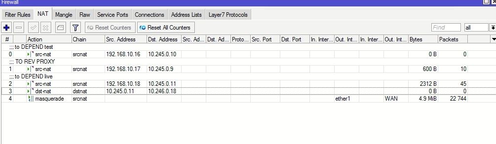

I am doing NAT on both sides
I have added a SNAT in microtik to translate local ip adress to transitinal 192.168.X.Y to 10.10.x,X and added route in microtik to forward all trafic to 10.10.x.X to 10.10.5.4(ipsec vpn interface ip on fortigate side) now I am reciveing the packets on fortigate side and I can see the answering packets going out of fortigate side but nothing in microtik
DO i have to add some type of rule in firewall or do dnat to work this out or what also as far as I know there is no ipsec interface in microtic so how can I set ip address on ipsec in microtic

  1. MT tunnel can’t work correctly for you, because the firewall entries on the mikrotik end are in a complete mix. The flow of traffic packets will not be correct. All this also affects safety! Fix the firewall. I will try to copy you an example.
    Masquarade fixes…Leave only out interface=WAN. We only use address-lists. In the NAT section, you can fix the roll above Masquarade.
    src-nat= src address(subnet x.x.x.x/24) and dst-address (x.x.x.x/24)

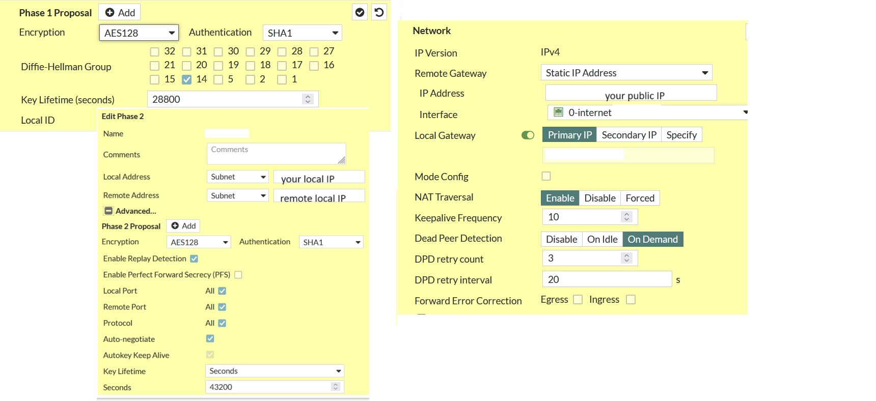

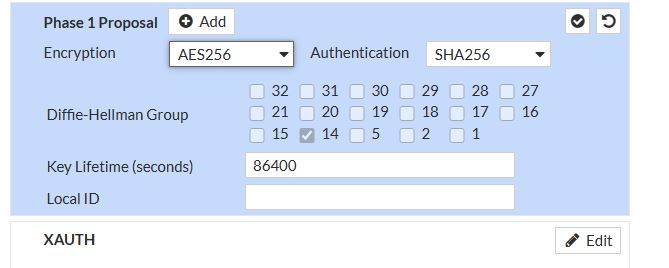

  2. On the Fortigate side, check whether you have the correct Phase 1 and whether the DH-gorup matches the Mikrotik side. Also check Phase-2.

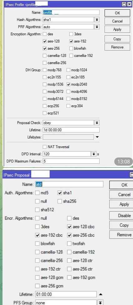

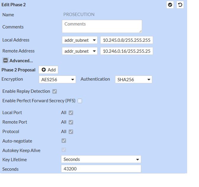

I have configures the settings as you have only used more strict security SHA256 and AES 256 but without PFS

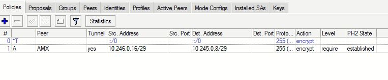

the tunnel is up but the traffic is one-sided
I can send the souprt.rif
the trafic is going out of the microtic but not comming back
ok, use stronger encrypt. It is everyone’s personal business.
But I would recommend starting with the mikrotik side. If you get the mix right, I think you will get the result

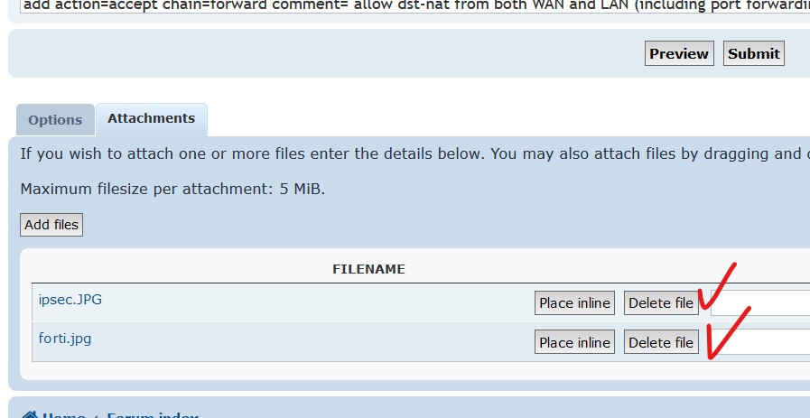

and can you tell me how to modify and delete a picture for example from the post
so should I have my Polices in the exact order that you written?
take the edit post and under “attachments” you will see the option “add” or delete.
Yes, it would be desirable. In general, we always take the ``default’’ firewall as the basis for everything and then supplement it with the entries we need. That’s exactly what I have. Of course, look for yourself and fix what you have WAN, what you have LAN…vpn and the rest.
thank you I wasn’t seeing it at first
I had to add another picture to see the attechment part
good luck :slight_smile:

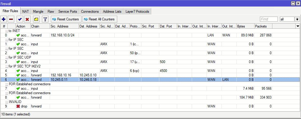

Flags: X - disabled, I - invalid; D - dynamic
0 D ;;; special dummy rule to show fasttrack counters
chain=forward action=passthrough
1 ;;; to INET
chain=forward action=accept src-address=192.168.10.0/24
in-interface-list=LAN out-interface-list=WAN log=no log-prefix=“”
2 ;;; FOR Established connections
chain=input action=accept connection-state=established,related,untracked
3 ;;; FOR Established connections
connection-state=established,related,untracked log=no log-prefix=“”
4 ;;; defconf: accept ICMP
chain=input action=accept protocol=icmp
5 ;;; allow dst-nat from both WAN and LAN (including port forwarding)
chain=forward action=accept connection-nat-state=dstnat
6 ;;; for IP SEC
chain=input action=accept protocol=icmp src-address-list=AMX
in-interface-list=WAN log=no log-prefix=“”
7 ;;; IKE IPSec
chain=input action=accept protocol=ipsec-esp in-interface-list=WAN
8 ;;; L2TP
chain=input action=accept protocol=udp in-interface-list=WAN
dst-port=500,1701,4500
9 ;;; defconf: accept in ipsec policy
chain=forward action=accept ipsec-policy=in,ipsec
10 ;;; defconf: accept out ipsec policy
chain=forward action=accept ipsec-policy=out,ipsec
11 ;;; defconf: fasttrack
chain=forward action=fasttrack-connection hw-offload=yes
12 ;;; Config Access
chain=input action=accept src-address=192.168.10.0/24 log=no
log-prefix=“”
13 ;;; for IP SEC UDP
chain=input action=accept protocol=udp src-address-list=AMX
in-interface-list=WAN dst-port=500 log=yes log-prefix=“”
14 ;;; for IP SEC TCP IKEV2
chain=input action=accept protocol=tcp src-address-list=AMX
in-interface-list=WAN dst-port=4500 log=no log-prefix=“”
15 chain=forward action=accept src-address=192.168.10.18
dst-address=10.245.0.11 in-interface-list=LAN log=no log-prefix=“”
16 chain=forward action=accept src-address=10.245.0.11
dst-address=192.168.10.18 log=no log-prefix=“”
17 ;;; INVALID
chain=forward action=drop connection-state=invalid
connection-nat-state=“” in-interface-list=WAN log=no log-prefix=“”
18 ;;; INVALID
chain=input action=drop connection-state=invalid connection-nat-state=“”
19 ;;; INVALID
chain=forward action=drop connection-state=new
connection-nat-state=!dstnat in-interface-list=WAN log=no log-prefix=“”
20 ;;; VPN
chain=forward action=accept src-address-list=VPN
dst-address-list=Local-LAN
21 ;;; drop all else
it is still onesided what am I doing wrong

I can’t do everything 100% for you, so try to slowly go through the configuration that I copied. Look at both ends what happens with the ipSec profile, Proposals. I think you haven’t looked at them.
no I copyed them tell me me I if i Miss anything but other then the difference in sha and aes the rest is the same I even took out the PFS I also tryed with ikve V1 and V2

I am have the src nat working but I dont know if need dnat also I will try what you were telling in your first post
